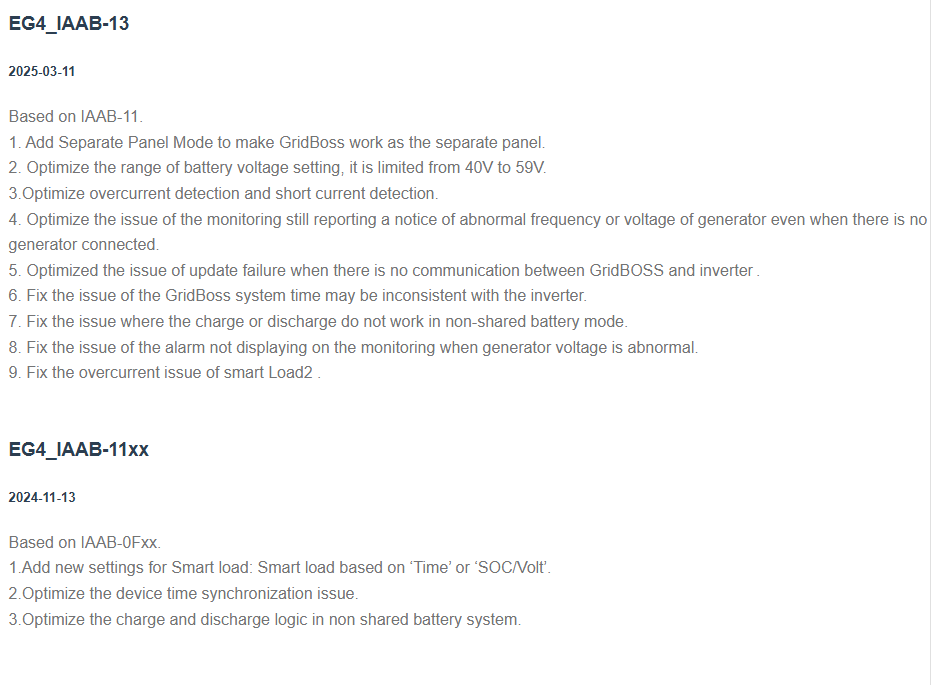

I recommend updating the firmware on the Gridboss. The last two updates include several fixes for issues previously reported with the Gridboss.
(@larryz)
Posts: 7
@eg4eric When I updated to IAAB-1300, the log cleared and the warning hasn't come back (although I still don't have a generator hooked up and there is probably still stray voltage on the terminal since it's probably a high impedance, unterminated input)

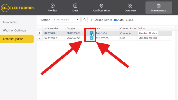

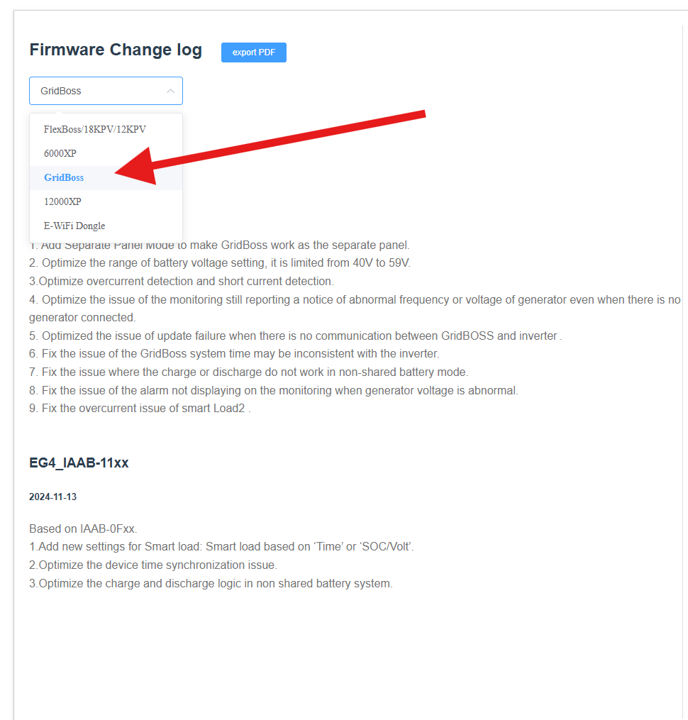

@larryz Once you register an account and add your device to the EG4 monitor website, you can go to the EG4 Monitor website and click on Remote update, you will see a question mark (See picture for reference) and once you click it you will click on Check More and you will have the option to click on the Gridboss firmware changelog.

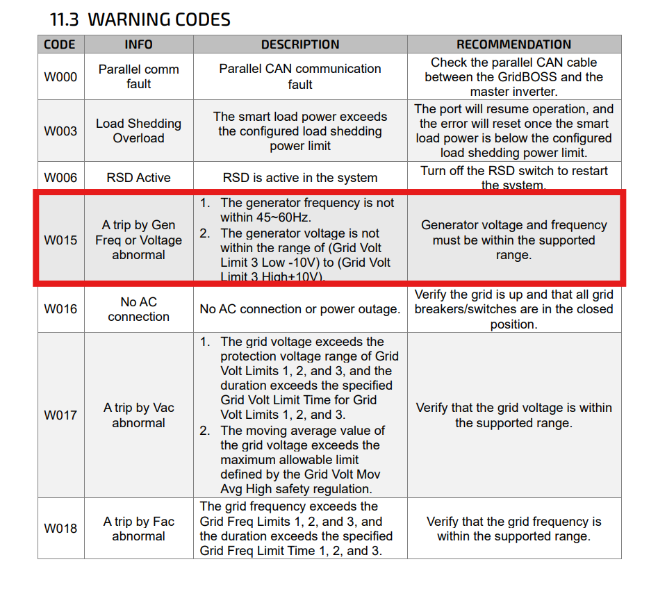

@eg4eric Sorry, I meant the table in your September 16th post.  The table was labeled "11.3 Warning Codes"
Posts: 1141
@larryz
Got it. Yes, it's available in the Gridboss Manual, which I'm leaving below. Starting on page 66.
