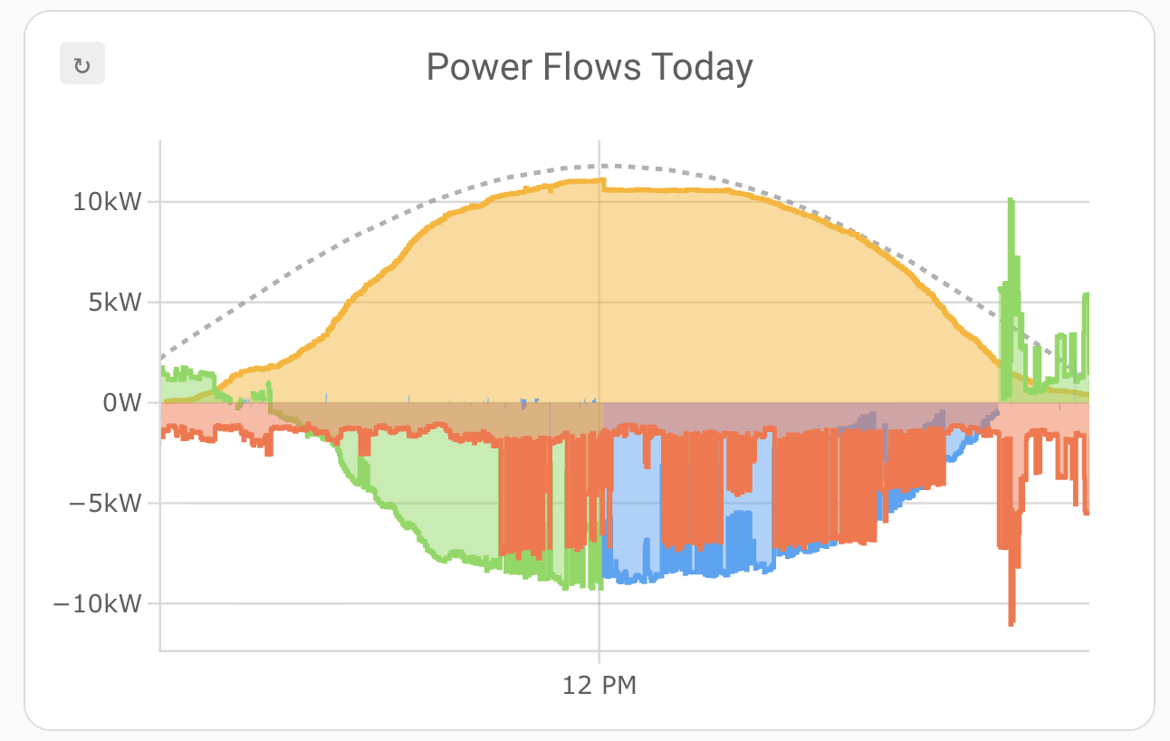

Graph of clipping event on April 4th:
Screenshot 2026 04 05 at 8.08.22 AM
Yellow is PV, green is power flow to battery, orange is power flow to house, blue is power flow to grid. dotted grey line is max theoretical power output of my system given angle and placement of panels.

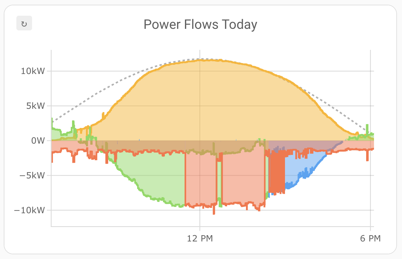

Graph of April 4th production with no clipping. Slightly higher power output because it was extremely windy and even colder outside.
Screenshot 2026 04 05 at 8.08.34 AM

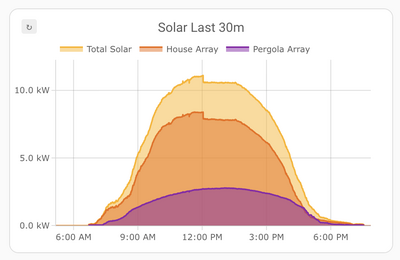

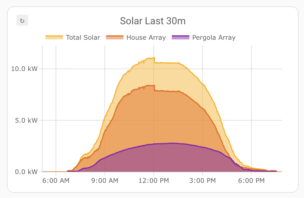

Here's another view. You can see House Solar, which represents PV2 and PV3, is where we observe the clipping event. Very strange.
