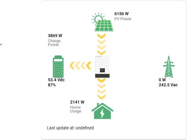

I was playing with the "Lux power-distribution card Card" and it has a field for "Last updated" and was curious if that information could be scraped with your wrapper?  Here's what I got with that card, it kinda makes it look like the one that EG4 outputs.

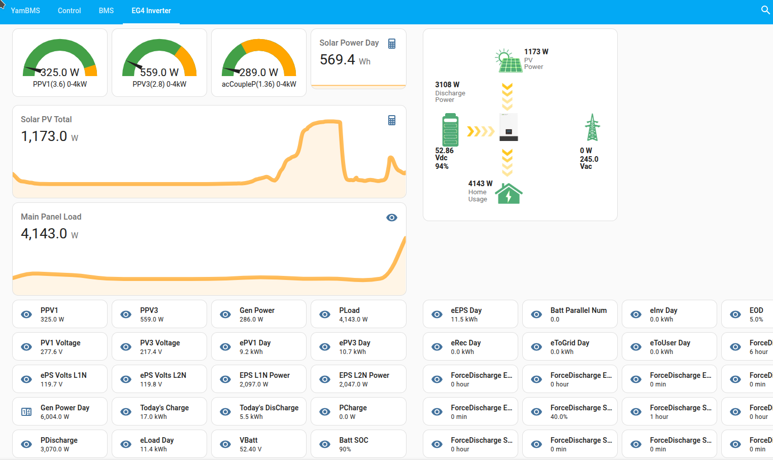

@lemming I've been using Python protocol Gateway(PPG) to talk to my EG4 18kPV and since it exports MQTT I'm pulling in the data to Home Assistant from MQTT.
I like the familiar animation/dashboard so might have to pull that in and setup all the data points. I also have YAMBMS running between my batteries and EG4 so i have lots of battery info too.

(@lemming)
@dougl For you it would be something you'd probably just have to code as it's not one of the data points for what you're using.  You can also just remove that entry.  I just thought it may be nice to see when the monitor.eg4electronics.com site updates the data.
You'd just remove these fields if you want to remove it:
update_time:
entities:
- sensor.
show_last_update: true
And it'll remove it from the card.

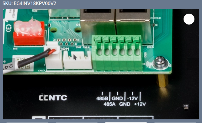

@dougl I just found this thread and I am hoping you can bring me part way up to speed on using PPG. I also have an 18kPV.
  1. How are you connecting the Inverter to the PPG USB port? It looks like there are a couple of options.
  2. Are you using the PPG HASS Addon?
(@dougl)
Posts: 89
@weertske I'm just running PPG on an rPi with it setup to send MQTT messages to a Mosquito MQTT server and then I have Home Assistant pulling the MQTT messages.  There is an RS485 port in the screw terminals below the CAN connectors:
After that I integrated some of the messages into my dashboards like this one:

(@weertske)
Posts: 17
@dougl Thank you. For the wires coming from the screw terminals, are you connecting to something like this? Or do you have another approach?
