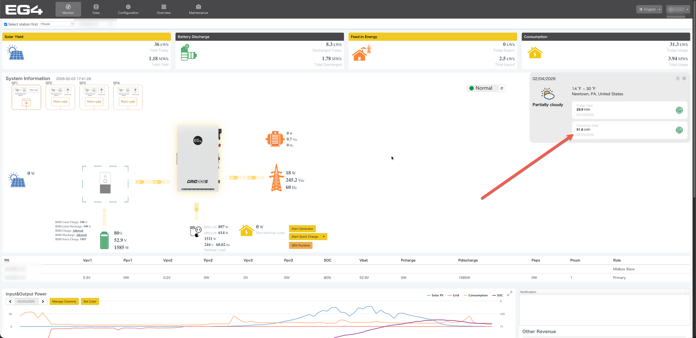

On the Monitor homepage, today is shown as partly cloudy and tomorrow is clear with an estimated yield almost 2x today’s production. That lines up with what I’m seeing from Weather.com and other forecasts (I’ll attach screenshots).

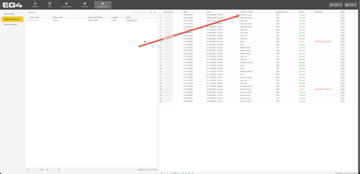

However, in Maintenance > Weather Optimize, the "Weather next day" entry for the same date shows "Overcast clouds", and based on that, Weather Optimize is setting a much higher battery charge percentage. So the dashboard and Weather Optimize are clearly not agreeing on what tomorrow’s weather looks like.

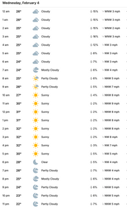

I’m not trying to nitpick -this just has real impact on grid charging and battery cycling on days that end up being very sunny. I’m attaching screenshots of:
- the Monitor homepage forecast and yield estimate
- the Weather Optimize log showing "overcast"
- and the actual weather(dot)com forecast for the same day and location, taken at the same time (5PM).
