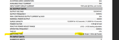

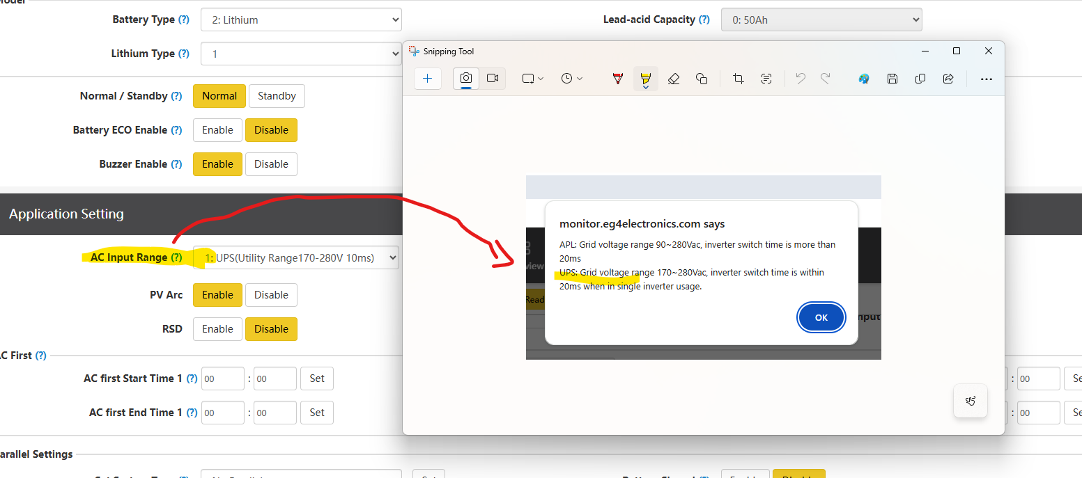

@dtbaker61 ... I have very similar setup with 6000xp and 2 280Ah indoor batteries.  I have noticed this problem as well ... I changed this setting via the Web monitor application (Old Setting Page).

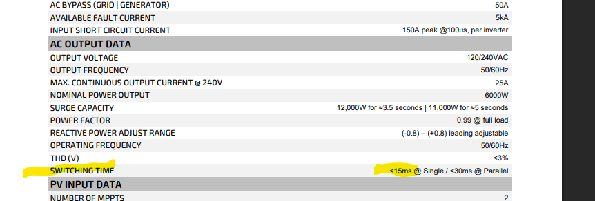

The spec says <15ms switching time.
My thought it that if there was enough input power (solar or generator) for both the load (consumption) and charging the battery ... that when it stopped charging the battery it "flips" back into UPS mode (the EPS function) which causes the AC Power blip.
Oh, I am on firmware version ccaa-1C1212.
I will be able to see if the change to the AC Input Range fixes this problem this weekend.  Just thought I'd post here in case it would help.
