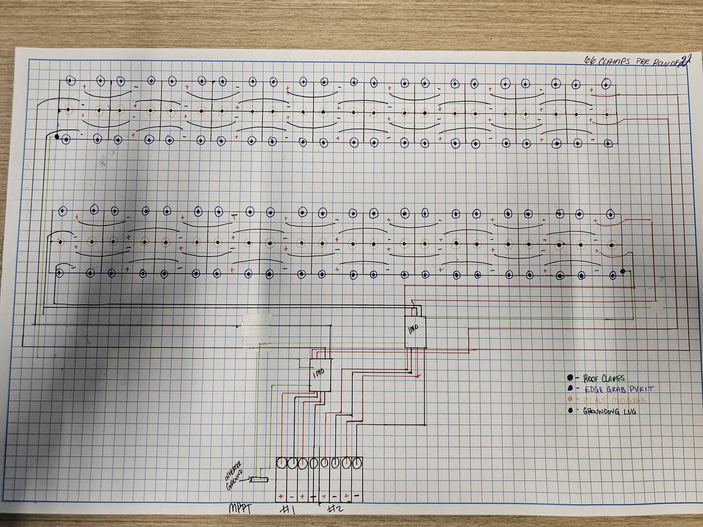

My Signature Solar designer sent me this plan for my soon to be installed 44 panels into a 12000XP. I have not verified the max V or I in but he mentioned he has. He said buy #10 wire for mine.
House Solar Wiring
Hope this design helps...
Posts: 29
(@frugal-farmer)
Also, no combiner box, only 2 IMO DC disconnects. (4 pole - 2 strings)
