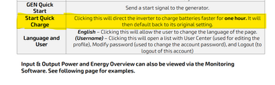

@eg4eric In the EG4 monitor phone app... there is a yellow button "Start quick Charge". I don't see any "i" help on screen, and no detailed explanation in App documention. What, exactly, does that "start", and what parameters does it look at ?
Posts: 1078
@dtbaker61
Sorry for the late response! It will make the inverter charge the batteries for an hour using Grid.
