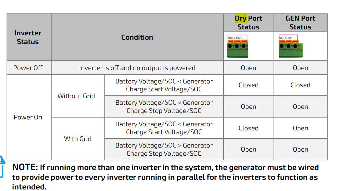

The only difference I see is if you have grid or not.
With Grid the Gen contacts behave a little differently as it won't close the gen contacts when there is grid.

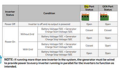

I found that table in the Manual, Yet after some tests it seems doesn't reflect the dry contact behavior.
I have connected two test wires to Dry contact NO2 and COM2 and it seems to be closed at the Battery voltage above the Gen charge start voltage - I have set it to 50V and with current voltage 52.3V the contact remains closed.
Once I switch the inverter off - the NO2 contact opens as intended.

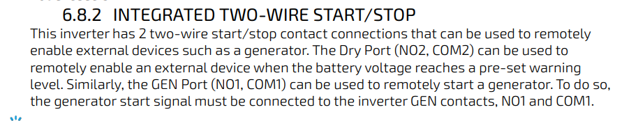

Posts: 1301
If you are wanting for the generator to start and stop according to the charging parameters, you will need to connect to NO1 and COM1.
