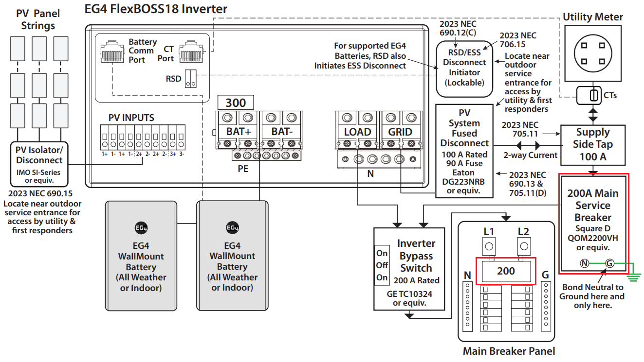

Hi, just bought EG4 FlexBOSS18...below wiring diagram is from their website. Want to know if the 200A breakers shown in the diagram (in red) is actually a same breaker and not 2 separate breakers?
