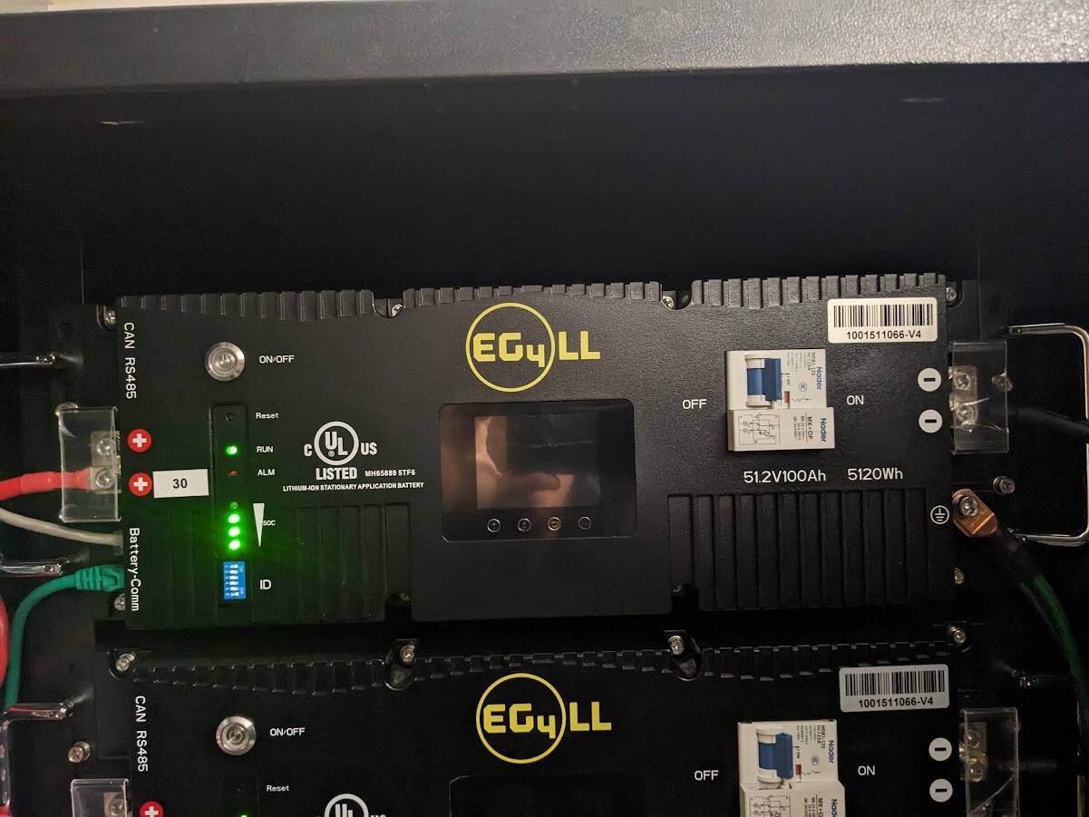

@eg4eric
This is a 4dip unit.

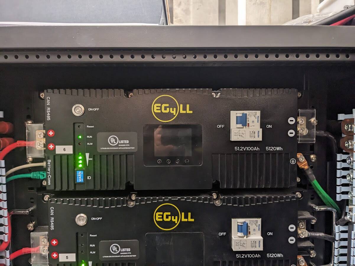

PXL 20251007 180210176
6dip unit, the "cluster master" is one of these.

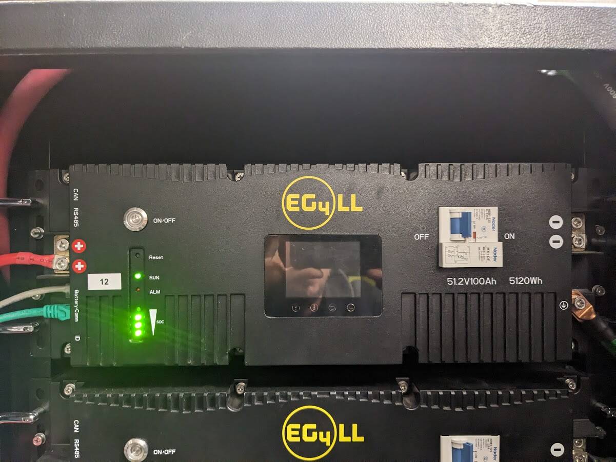

PXL 20251007 180112758
6dip unit.

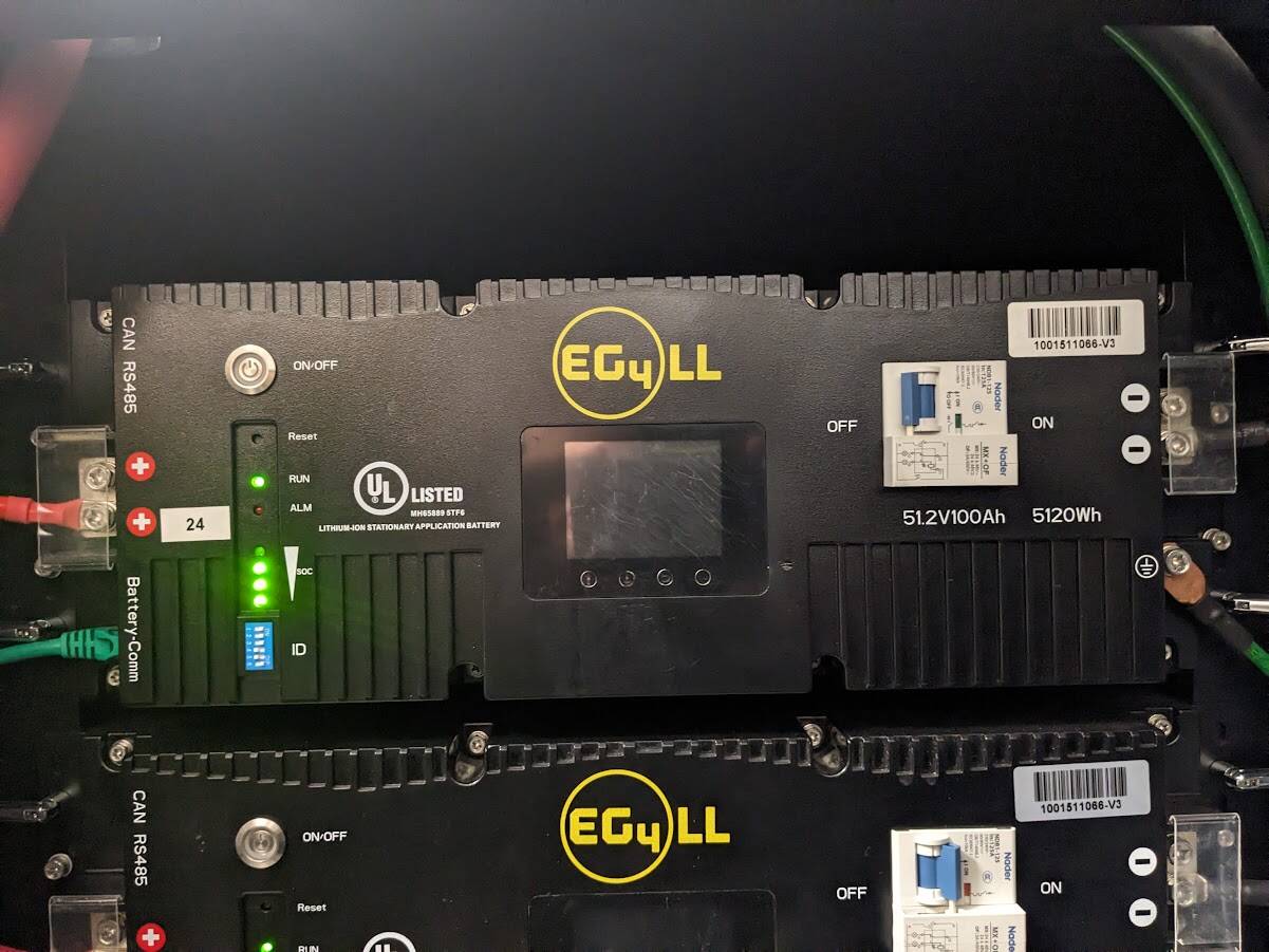

PXL 20251007 180141429
6dip unit, these were labeled as LL-S when purchasing.

I do NOT have any Lifepower4 units.  The multi pack firmware package has the firmware for 4 types of units.  LLv1, 4dip LLv2, 6dip LLv2, and Lifepower4; all listed as firmware version Z02T12.
Per the firmware change logs, firmware version Z02T13 supports v1 and v2 units.  I will also repeat, that I currently have Z02T12 installed on ALL battery packs, even the LL-S units using the 6dip LLv2 firmware, so based on the change log info Z02T13 should be compatible with all of my units as it lists both v1 and v2 as being supported. The firmwares listed as v3 supported do NOT have a 4dip option included in the latest download so I am guessing the last firmware that would support all of my units would be Z02T13.
I have NOT tried putting a firmware listed for v3 units on the 4dip units as there was no longer a 4 dip and 6dip option listed in the download package so I assumed said firmware would not support the 4dip unit and could possibly brick it.
Z02T13 is the firmware that I need a download link for to fix the mod bus register overflow issue.
I suspect my 4dip units are actually v2 as they are still functional after putting the v2 4dip firmware on them.  With that said, would the latest firmware support being installed on my 4dip units without bricking them?  If not then I still need a download link for Z02T13.
