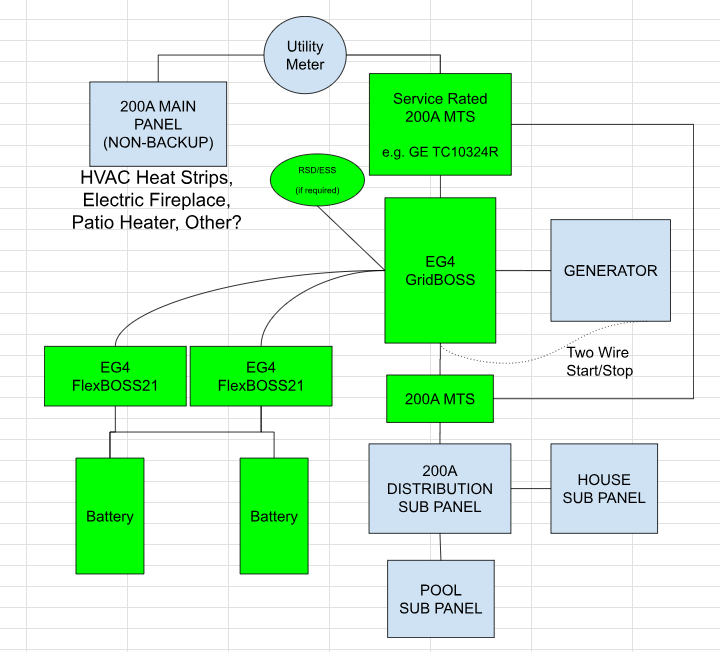

(@jasonjoel)
Joined: 3 months ago
In case it helps, here is how I THINK it will look in general (I'm not an electrician, just a semi-competent idiot).
