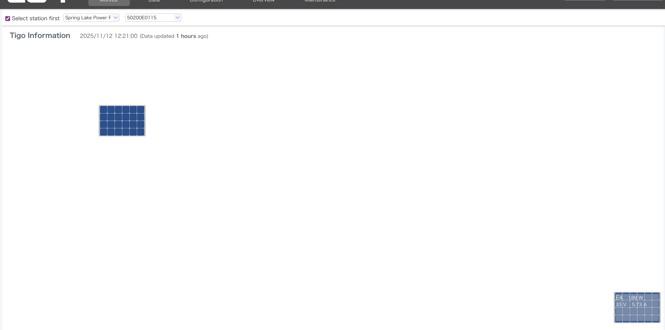

(@leelloyd3)
Hi Everyone!
I've had my system up for nearly 3 weeks. So far I haven't been able to get any data from Tigo pulled into the EG4 monitor website. It just looks like this.
Screenshot 2025 11 12 at 12.26.35 PM
I've tried waiting, removing and readding the Tigo account but it just returns to pulling the same 1 panel that this screen shot shows.
I'm about ready to give up, just wanted to see if there was anything else I should do.
Thank you!
