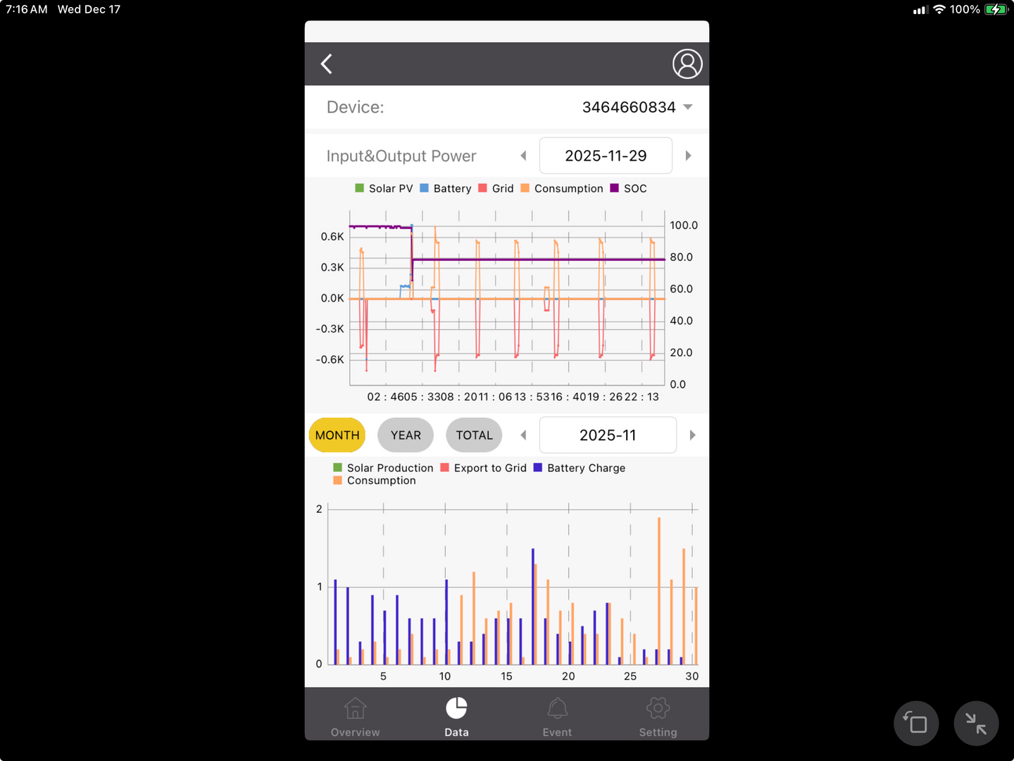

My current configuration is a eg4 18kpv with 6 eg4-ll batteries. I’m connected to the grid. I plan to add pv but at present the system is my backup when the grid fails. I’m in the Allegheny national forest so power outages are a regular occurrence.
since I installed the system I’ve had 2 times where during a grid outage  the soc drops and the batteries are unavailable. I was not there both times, but when I drive there I find the batteries showing 0 soc and once I cycle the bms breakers the inverter begins to charge the batteries. The grid consumption is 30kw+ house usage.  So the batteries were drained. The data history doesn’t show anywhere near 30kw of consumption from the batteries for the months prior to each event. And there is charging activity seen in the data.

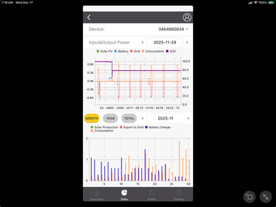

here is a screenshot from the app on my iPad note the inverter sees soc as 87% while the batteries show 0%

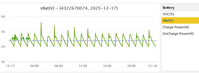

I have an identical system - one 18Kpv and six LL-S batteries used as EPS standby - there is no PV. This is a battery backup system only. Your system is draining the batteries by 6% per day from standby current, and this amount is not registered as a drop in SOC by the BMS. i.e. the SOC drift in this scenario is very bad and it causes the batteries to be depleted while the reported SOC remains very high, nearly 100%. The solution is to switch your settings to voltage charging control and not use SOC control. Try these settings:
Battery Backup Mode: Enabled
Batt Charge Control: Volt
Start AC Charge Volt: 53
Stop AC Charge Volt: 56
With Battery Backup enabled, the inverter will do a brief charge about once per hour to replace the EPS standby power being consumed, keeping the batteries topped up. You should see vBat being kept above 54V as in this graph from my system. Note that if you enable battery backup but leave the system in SOC control instead of volt control, then this periodic recharge will not occur, and the battery bank will lose about 6% per day.

I assumed the same thing at first, but the operation makes sense - the inverter powers itself from DC (battery) all the time, so if there is an AC grid outage the inverter logic is never interrupted. So, EPS standby power comes from the battery. Once you get this working with my suggested settings, what you should see in the data charts is 1.8 kWh of battery charging energy total every day, and battery voltage staying above 54.0V. And hopefully a vBat graph similar to mine showing a bump in charging about once per hour. Good luck!
