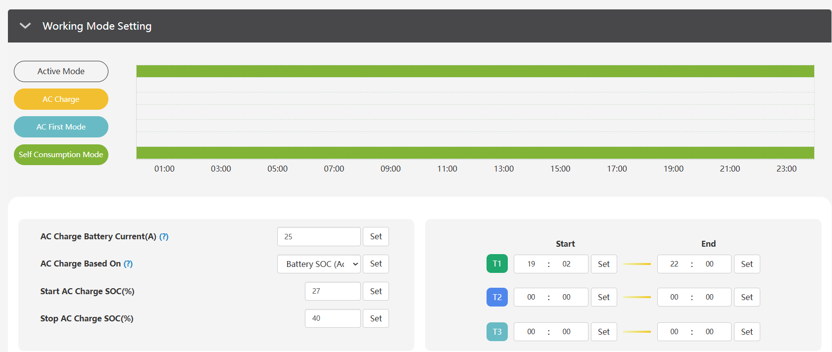

@ezpz Noted and thank you for the input. I am attaching the system configuration settings for reference.  From my observation, it appears that the connection to the GRID activates when there is a significant load or production swing where the inverter's power level cannot keep up with the power swing.  Due to customer requests, my post was to get clarity from EG4 gurus on the observation(this is not mentioned in the manual).

Those settings look fine.
And yes sometimes the inverter uses the grid if there are big power swings. It might import power from the grid or even export a little to the grid before the inverter “catches” up. The only way to avoid that is to enable offgrid mode or physically switch off the main grid breaker, but that risks things not starting in the house or at least struggling to start with huge loads.

Hello, I've got my XP6000 running my barn on backup power (EPS) with the battery (soon to be "batteries") being charged via solar.  Operating well but I have 1 question and 1 issue.  Maybe you all can help.
1st - My monitoring screens and setup are not the same as shown.  @sylinx, were those screenshots off the phone app or a laptop?  As an example, I do not have the working mode options shown in posts above.  Do I need a firmware update in the XP6000?

@old76ta
  1. Yes, the screenshots look like they were from a phone.
