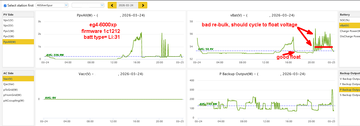

I did update a client to ccaa-1c1212 , and open-loop charge control by voltage does now  appear to work almost cceptably. System charges to bulk, ends charge, and drops to float.... all good as long as incoming PV > Load. However, if Load >PV, vBatt will drop -1.0v below float, and re-bulk to end-of-charge, stop charge, and drop back to float -1 and cycle again.
this can result is some weird looking
2026 03 25 shows bad re bulk cycle
battery voltage in the afternoons. better than holding at bulk, but *should* cycle only up to Float, not Bulk voltage
