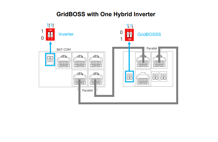

I’ve been doing a lot of troubleshooting to try to determine the problem of not being able to charge the batteries or use the batteries to carry load. The unit will not stay on, tripping to standby with each reset.
Now when I initiate a restart the batteries pick up load , some internal fans immediately kick on, and after only 5-10 seconds the unit alarms “para sync loss” and trips to standby
i think I have a hardware issue like a bad board or something
Posted : October 8, 2025 10:02 pm
Ensure that the cables are properly connected between the inverter and Gridboss, and verify that the DIP switches are set to the 'up' position on both devices.
Posted : October 9, 2025 8:49 pm
(@solartom)
Posts: 5
@eg4eric Doesn’t this drawing show one up one down?
Posted : October 10, 2025 3:31 pm
I apologize for the confusion. You are correct. The inverter DIP switches should be in the up position, and the GridBoss DIP switches should be in the down position.
