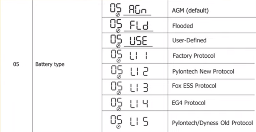

The 3000EHV is only compatible with certain batteries. If you can set the battery protocol with one of the following protocols, you could possibly get communication.
Screenshot 2024 10 30 094159

@eg4eric The point is that I WANT to use open loop "USE" protocol for off-grid reliability. The problem is that with Open Loop, the SmartESS software is not very smart, and does not calculate SOC% or track actual kWhr in/out of the battery.
