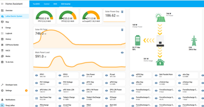

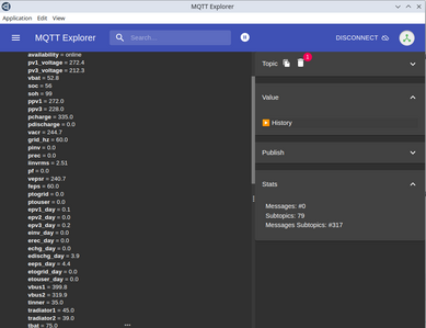

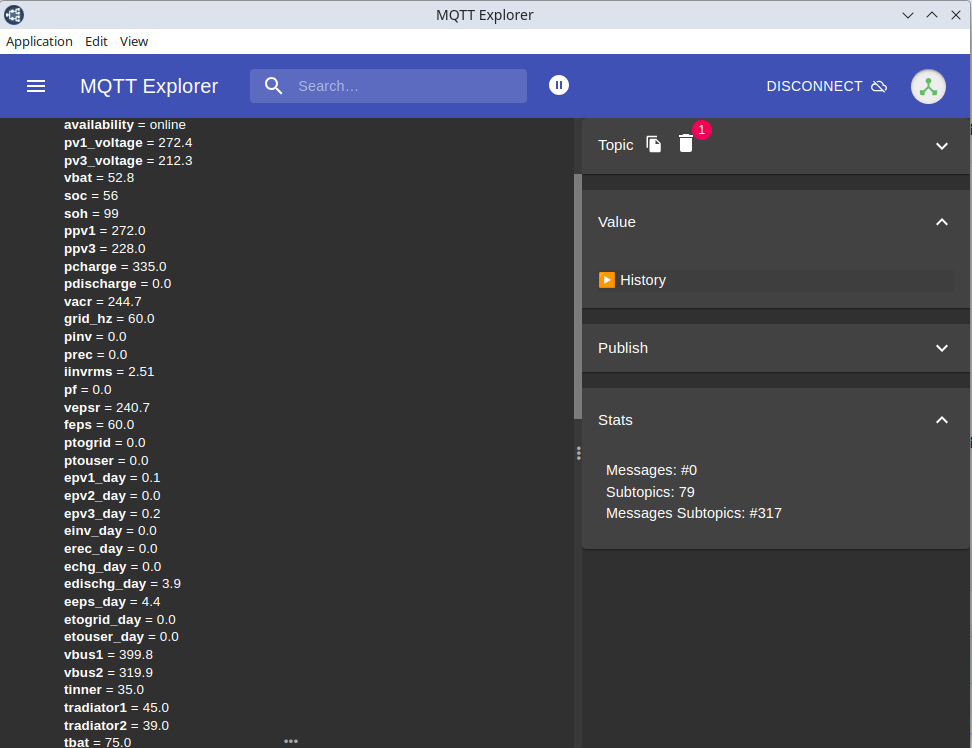

Depending on your skill set there is an option which combines 2 open source projects. To get data from your EG4 inverter( 18kPV and 6000 supported ) there's Python Protocol Gateway( https://github.com/HotNoob/PythonProtocolGateway ) which I run on a Raspberry Pi and connect to the EG4 18kPV via RS485->USB cable.
It acquires data from the inverter and publishes it to a MQTT server( which can also be running on the Raspberry Pi. For display I use MQTT Explorer.

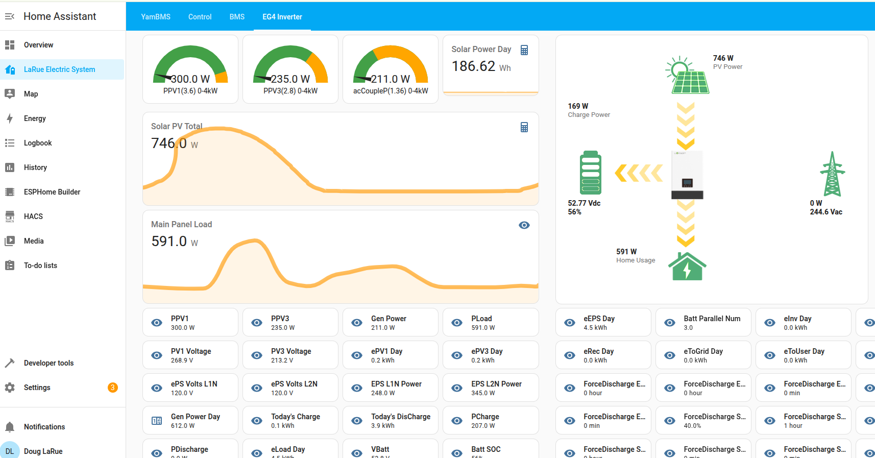

For a better looking display than a bunch of MQTT messages the next open source package is Home Assistant( https://www.home-assistant.io/ ) which can also run on the Raspberry Pi.
It can do far more than display solar inverter data for example I have a 3rd open source package in my solar system setup which is YAMBMS( https://github.com/Sleeper85/esphome-yambms ) which sits on an ESP32 between my batteries and the inverter and allows me more control of information and charge/discharge and many use it to read from a Smart Shunt for more accurate SOC information and provide that to the inverter instead of what the batteries think is their SOC. I have a CAN interface from the ESP32 to the EG4 18kPV inverter and another one to the DIY Basengreen batteries(3*16kWh).
Here's one of my 4 solar system display panels seen in a web browser.
Unfortunately, while Home Assistant sells a kit to get going, the YAMBMS doesn't but Python Protocol Gateway is, like Home Assistant pretty much a software only solution for inverter data collection and display. They are Linux solutions and as you mentioned, they are local LAN based so no Internet connection is required and no data is lost if there's a cloud issue or Internet disconnection.

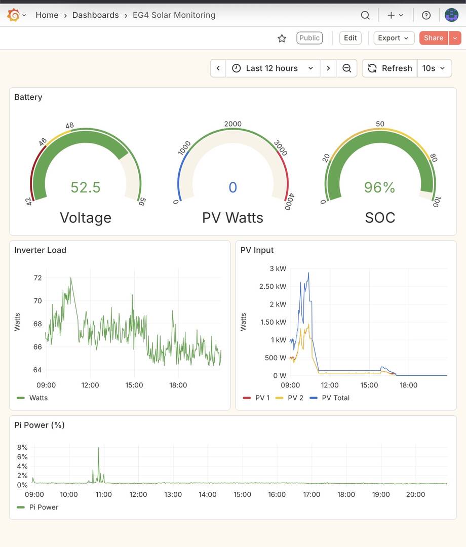

@dougl I, too, am looking at polling my 6000xp for battery, inverter and PV information.  Just recently I completed my own Telegraf, Influxdb and Grafana setup on a Pi 4, pulling data from the SA mqtt broker. I’m now working on getting data directly from the inverter to bypass (without prejudice!) Solar Assistant.  I didn’t want to get into HA. Didn’t want to have yet another app I needed to master.
Thanks for the GitHub link. I’ll look into this asap.

@dougl I posted before that I’m capturing the SA mqtt broker output for my monitoring system. What did you use to get data directly from the inverter? Did you use an hdmi to RJ45 adapter or just pickup the Wi-Fi dongle output directly?
(@dougl)
Posts: 89
Posted by: @marobel
I'm using Python Protocol Gateway on a Raspberry Pi with an USB-to-RS485 cable which came with one of my Basengreen battery packs. On my EG4 18kPV there is an RS485 port under the RJ45 connectors on wire terminals. That's the RS485 channel I'm using. I believe it's used for intercommunications between GridBoss and FlexBoss devices.

Yes, I’ve seen that the the more advanced EG4 inverters. They have the terminals you can tie into.  The 6000xp does not have that same setup.  I was hoping to get the information by using the paralleling ports (whereby you can add multiple inverters). It seems like this should be exchanging the information I’m looking for.  I just need to get that worked out.

I’ve finally got all this working! I outdoor that the dongle had to be removed for me to get good data from the rj45 connection just above the Batt Comms plug. Found the inverter register mapping and used that to decide the data.  Now dumping 30 second readings into json and getting directly into my Grafana visualizations.
