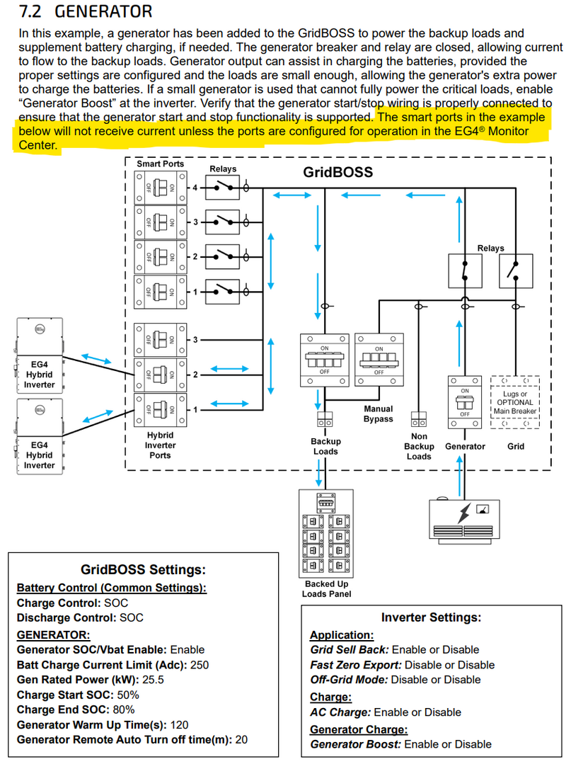

A smart load can be enabled if the grid is present regardless of SOC and other parameters.
A generator can provide the same kind of assist the grid does (but on a smaller scale). Does a smart load enable if the generator power is being used? Could there be a second option to enable that?

Sorry, this is for the GridBoss smart loads. Inverter would be the FlexBoss21

The Smart ports will not receive current when using the generator unless the ports are configured for operation.
