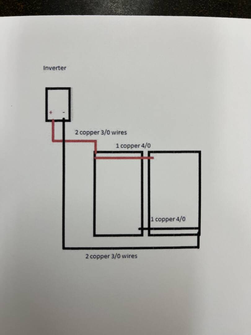

@eric I’m still get a difference in charge and discharge on the new V2’s compared to the 9 older ones. I’m going to put a picture up and show you how I have them wired and see if you think I should do something different.
How do you have the batteries connected?
Are you using external bus bars?
(@pawnee)
Posts: 155
@eric
2 EG4 battery racks connected to 18k with 2, 3/0 cables for positive and 2, 3/0 negative. The 2 racks are connected by a 4/0 positive and a 4/0 negative cable. Here is how it looks

@pawnee If I remember your OP correctly, the three new V2's are just filling out your second rack?
The original setup was charging all batteries correctly and it wasn't until you added the new V2's to the second rack that batteries started charging and discharging strangely?  And only the new batteries?

@joel-brodeur Yes last 3 of the 12. It's pretty strange. When PV or discharge is low, they all pull the same amps. When PV or discharge is high the newest batteries pull around half the amps. It usually goes like this.
Charging from 47 volts to 54 volts or so most batteries are pulling 10 amps and the new ones 5 amps. Around 54 volts the older batteries BMS start slowing down charge amps to say 1.5-2 amps and the new batteries start pulling 10-11 amps until they hit 56.4 where I have the 18K charge limit set. I'm still in lead acid mode cycling them so I'm hoping after a few more cycles they even out. If the age difference in the batteries was a couple years apart. I would expect some difference. The oldest batteries have around 250 cycles on them so I can't image that being the problem. I still can't get BMS test to work so I'm in the dark. I'll try to hook up to them again today or tomorrow and see what's going on.
Do you see anything wrong with the way I have the racks wired?? I can't think of a better way to do it, so I don't think it's a current sharing problem.

@pawnee I don't see anything wrong with the wiring.  It was working fine 9 batteries?
Just curious, have you tried an amp clamp to see if it actually charging/discharging differently and not just reading incorrectly on the monitor?
Offhand it almost seems as if the BMS is limiting higher charges and discharges.
