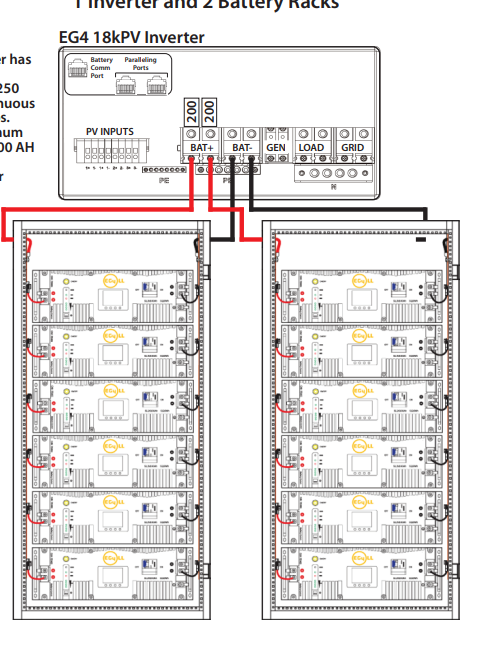

Posts: 1284
@pawnee
You can try connecting it this way. That way you ensure that the batteries are charging and discharging evenly.
(@pawnee)
Posts: 155
@eric yes I can. I’m taking it you don’t like the way I have it wired?
only thing I don’t like about yours is it appears there could be a current sharing problem if the negative leads aren’t connected to the bottom of each rack.
