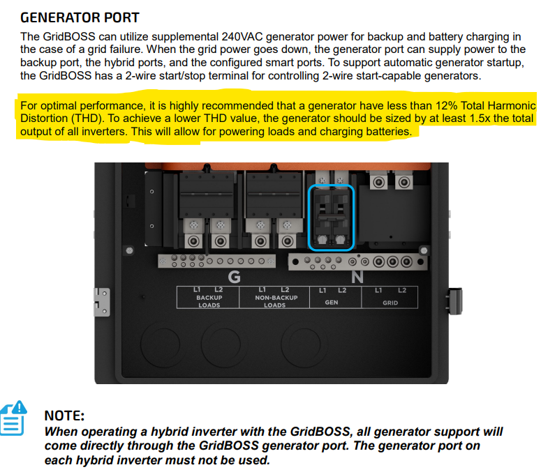

For optimal performance, it is recommended that the generator has less than 12% Total Harmonic Distortion (THD), is rated at least 1.5 times the total output of all inverters and provides a 240V output.
You can try to use a smaller generator with low amperage, but it is not guaranteed for it to work as it should.

I use a small 2000W 120VAC portable generator for exactly the scenario you have in mind - I use it to charge the battery bank and nothing else. In my case it runs through a Chargeverter and is connected to the battery bus. I limit the charging current to match the generator's capability using the settings in the Chargeverter. If you are going to try to use the generator input of the inverter or Gridboss, then as EG4 stated above you need to worry about sizing the generator to handle the loads that might be pulled through the system. I didn't want to invest in a larger generator just to handle this backup charging scenario, so the Chargeverter was a better investment to let me keep using my existing generator for the rare times it might be needed.

(@smity77)
Would you not just feed the generator into the GridBOSS, and have the FlexBOSS 'clean' the power?

@eg4eric
Please give a deep dive into this requirement. I have a system with 2 flexbos 21 inverters. That equates to a huge generator. NOTHING  in my house would require that size of generator. The worst load I have is a deep well pump.
Let's discuss the driving requirements for sizing the generator. And please explain in detail the settings and tradeoffs.
My system will also include ac connected solar of 10kw. How will the gridboss manage that during an outage to supply power and charge the batteries.

@eg4eric Would it be feasible to A/C couple an unbonded 120v 2000-4000w inverter generator with clean THD through a GridBoss Smartport instead of using an Autotransformer or Chargeverter?
@crws
No that would not be possible. That would not be a configuration that is supported by our system.
