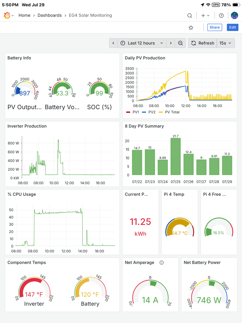

ErI’m cl I’ve tried to get this same information for my XP6000. Even at idle the temp is showing 130-140. The lower fan is running but the others are idle.  Is this temp reported by SA inaccurate or is there something more to this?

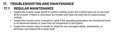

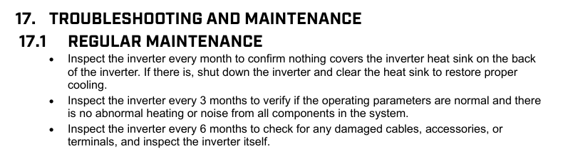

There is a small section in the Flexboss manual that does mention Regular maintenance, I know there are a lot of people that miss it, since it's only like 3 points.
