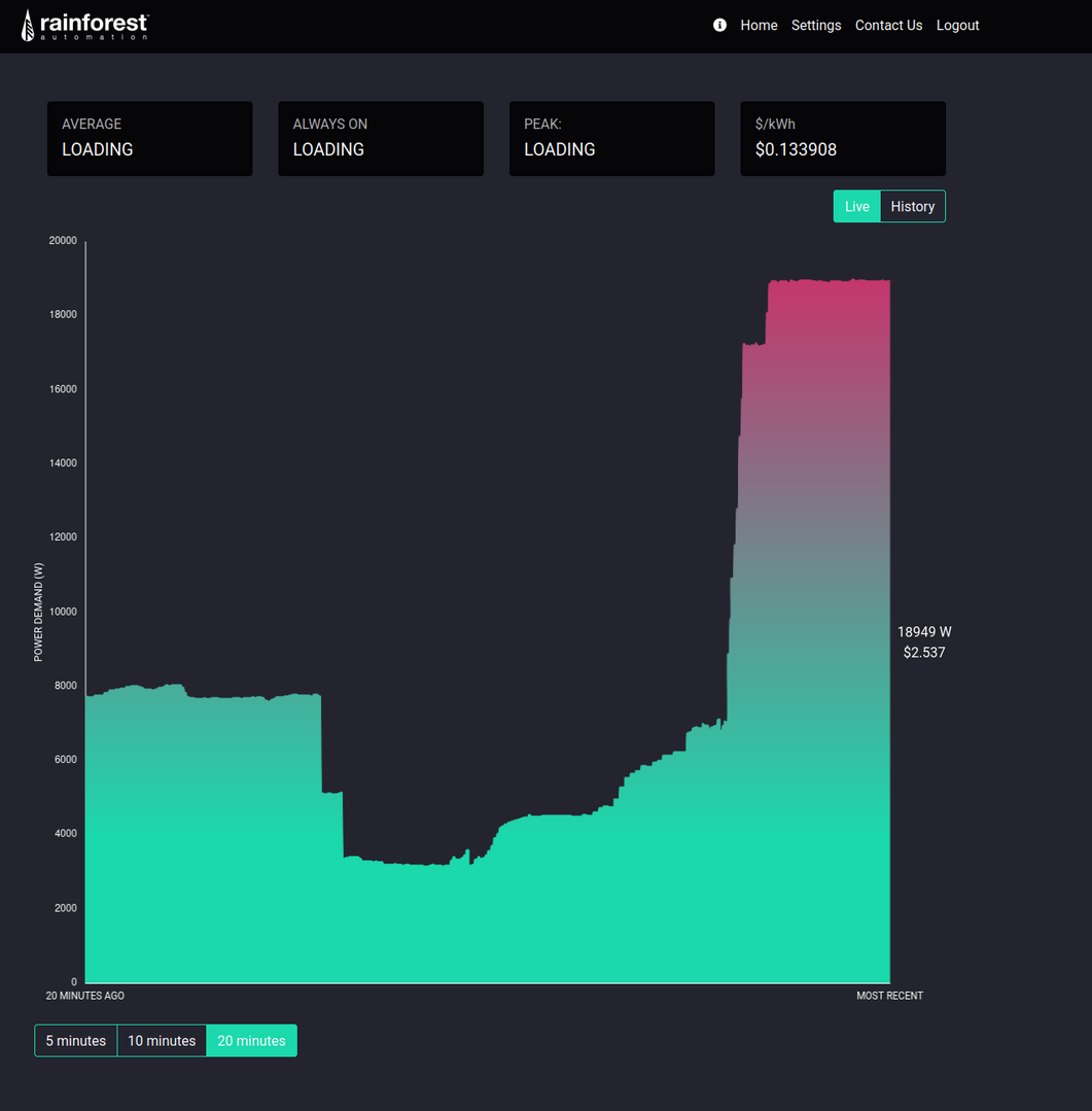

I have switched over to AC Charging Mode.  My smart meter reader shows that I suddenly jumped up 10kw in usage (which is how much I have configured).  See?

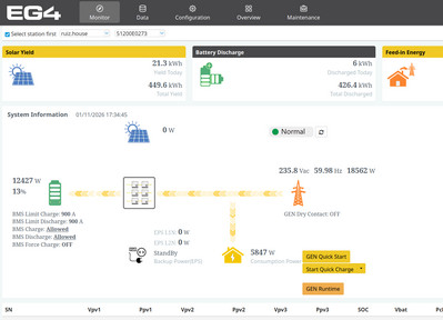

The monitor app's Monitor tab agrees that the battery is charging at around 10kW, see?

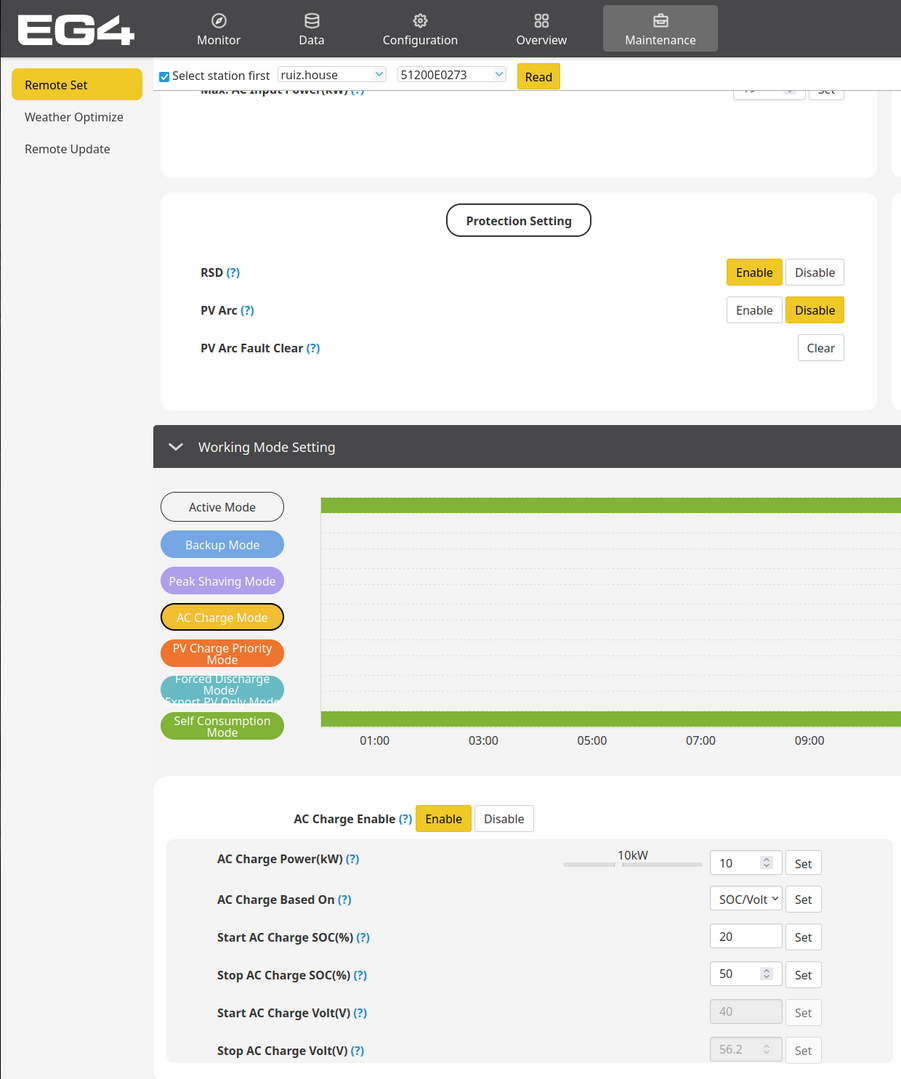

However, the Maintenance tab, with the leader inverter's settings read in, still shows that I am in Self Consumption mode, which I am clearly not.  see?
Not sure what to do about this.  It seems like a bug.

There are multiple reports across the board sbout EG4 monitoring issues over last few days.
i wonder why @EG4 Eric from EG4 has mot reacted to those.
it looks like systematic issue.
Will see
@jar349 @krzysiek_kta
I apologize for the delayed response.
Yes, we’ve been experiencing issues this week where the website and app are not displaying accurate data for some users. Our team is actively working to resolve this.
