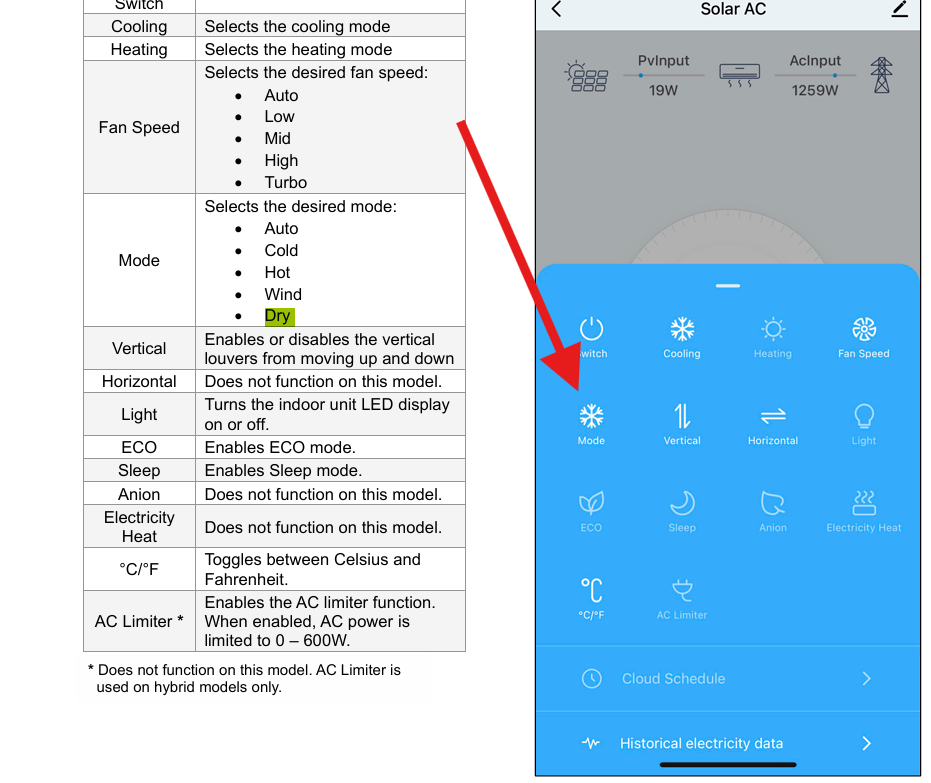

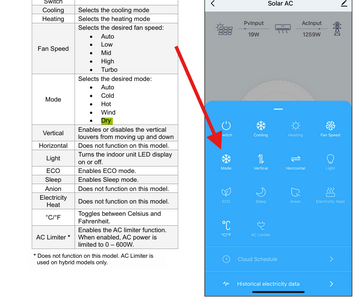

@krzysiek_kta
You should be able to select it through this option
