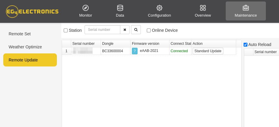

You can use the app or the monitoring website (Maintenance Tab) to update your inverter to the most recent firmware.

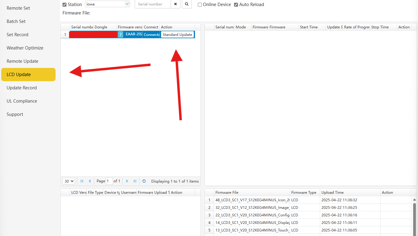

After further investigation, I was able to find that you should be able to update the LCD remotely through the monitoring website as seen on the image below.
Let me know if you have any trouble with this.

You have more options than I do. Mine does not have a LCD Update section:
Understood!
If you provide your station name or serial number, I can update the LCD firmware remotely on my end.

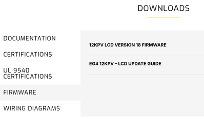

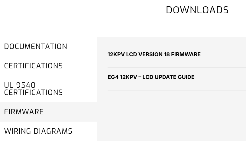

@eg4eric Sorry, really late in replying back to this. I got the LCD firmware updated (to version 18) a day following the firmware upgrade on the inverter.
