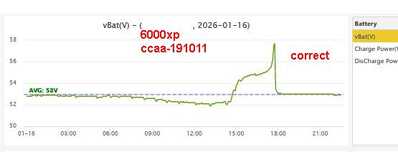

(@dtbaker61)
Posts: 153
@ouijifour the time it takes for voltage to rise from 54 to 58 (during the CV portion of charging) is typically plenty for internal top balancing for lithium. There is no absorb time required for correct LFP charging which is simply CC-CV to end-of-charge voltage. no absorb, and no equalize time is required.
Once Veoc is hit, the system *should* relax to a lithium-friendly float target of 53.0v or thereabouts.
260116 6000xp correct Veoc to Vfloat
The current 6000xp charge curve is pretty much correct
