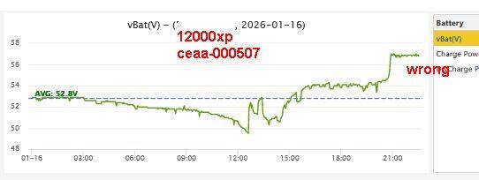

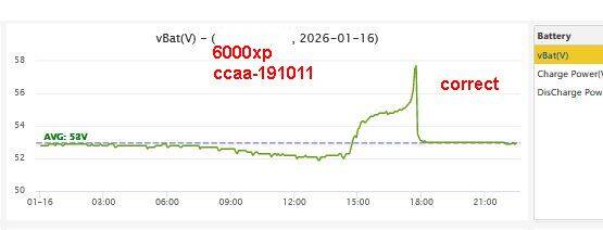

The 6000xp firmware ccaa-191011 seems to have fixed the bug with open-loop charge control for LFP... mostly. The resulting charge curve is "correct" most of the time as far as I can tell.
But, the 12000xp is NOT correct
260116 6000xp correct Veoc to Vfloat
260116 12000xp stuck at Veoc

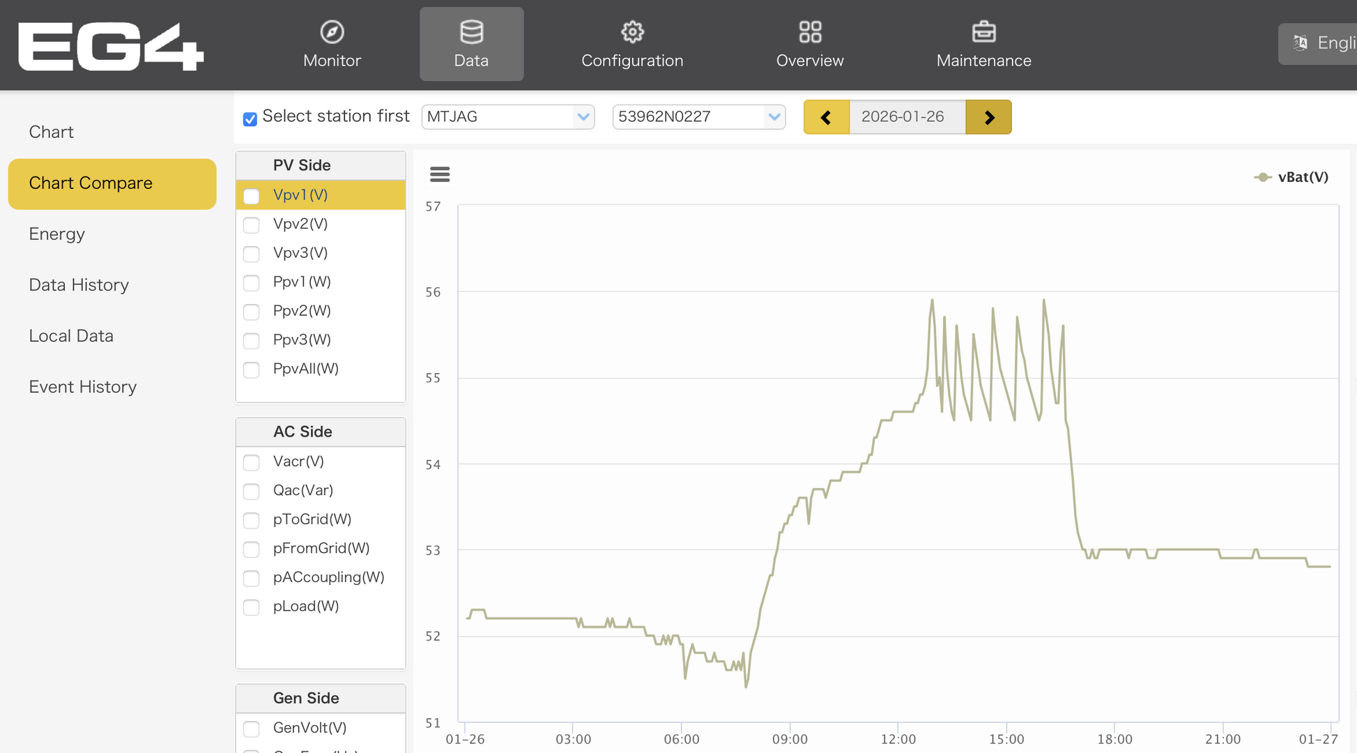

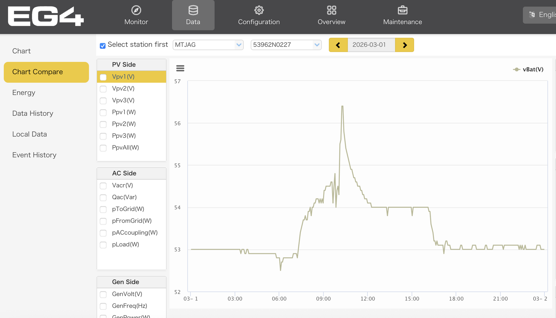

Since setting my batteries back to Lead Acid, the last three days show my system reaches 56.4v for 4-8minutes then drops back lower eventually getting back to Float at 54v (1st screenshot) as opposed to (2nd screenshot)

(@ouijifour)
Posts: 20
@mtjag is this with the new firmware ? In your lithium plot on the right did you have closed loop with bms talking to batteries ?  The first one on left ( lead acid ) does look like it is holding float pretty good. Did you have loads on it through out the day ?

(@dtbaker61)
very interesting.... can you export all your settings: Maintenance>read>export PDF and post so I can see what's different?
you might take a look in Data> DataHistory to see if vBatt is actually hanging at float, or just taking a long time to sink to vFloat-1.0 v if you have very small loads. I don't see the cycling until/unless loads > PV pull down the vBat lower than vFloat-1.
(@mtjag)
Joined: 10 months ago
Posts: 21
@dtbaker61 The screenshot on the left is with Lead Acid selected as battery type and the one on the right was with Lithium selected as battery type.  Vbatt is holding a float for most of the day based on Date>DataHistory with the settings Lead Acid
