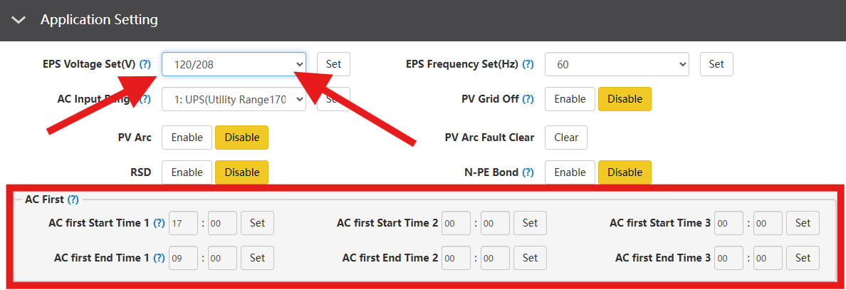

Hello, my apology is this was covered already, just not having good luck finding exactly the same situation.
We have a 6000xp that we want to run in UPS mode, a long with 100ah eg4 48v battery. No solar, just grid power + battery.
It does work, but it's also continually charging and discharging the battery, non stop. And during some of the switching the light and some of the power supplies flicker or cycle.
I have two questions:
1. Is it possible to set up inverter to use grid power always until power outage?
2. We have 120/208, is there some setting that controls the 208 vs 240? Or is that automatic?
Thanks

It should automatically detect it; however you can manually set it to 120/208 through the application settings on the Monitoring website, or you can use setting #4 on the inverter screen to set it.
You can set the AC First start time from 00:01 to 23:59 to allow AC power to run the loads all day and preserve the battery. Keep in mind this is an off-grid inverter, so it primarily relies on battery and solar, but using the grid to power the loads throughout the day is possible.
