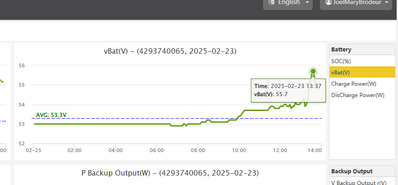

Right when my system hit 100% when using only solar my inverter shut down for a few seconds and then came back up.
I checked the logs and the only one I found was A25.  If I am reading the manual correctly A25 would be a battery over voltage???
Any ideas what would cause this.  Minimal loads never happened before that I am aware of. Snip of the data tab on batt volts:
