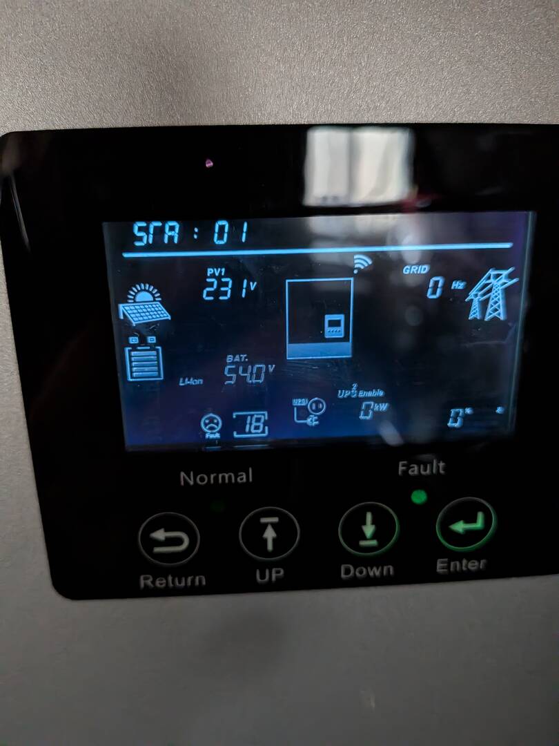

@eg4eric finally was up there and got a picture of the error code. It goes out for a few seconds then everything comes back up normal and is great until I shut it down again.

PXL 20260330 133913886
