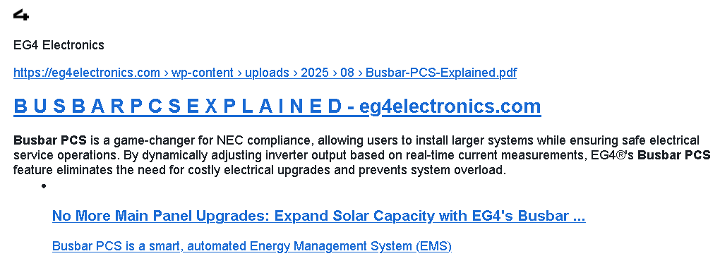

I believe it was an  email.
Attached is the brochure, links..
        https://eg4electronics.com/wp-content/uploads/2025/08/Busbar-PCS-Explained.pdf
Matt

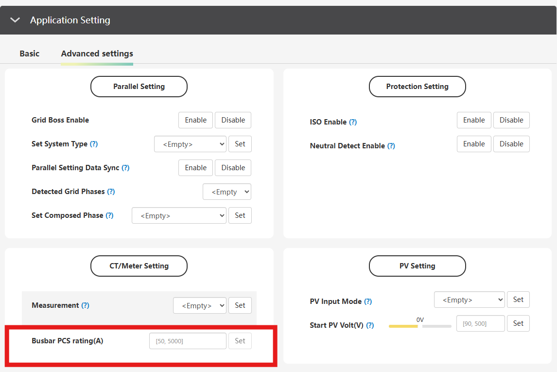

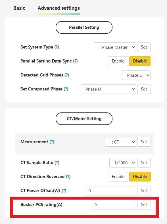

@mattcrum
This feature is available now on the hybrid inverters.

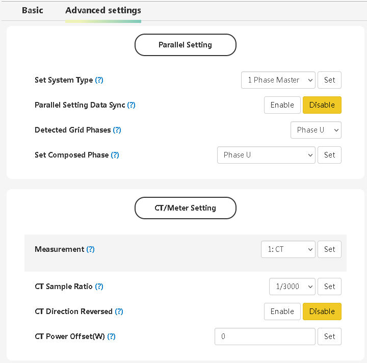

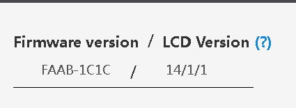

@eg4eric
So my 18K would need to have a firmware update ?
Thanks,
Matt
@mattcrum
You shouldn't have to update the firmware. You should be able to see it under the CT Power Offset(W).
