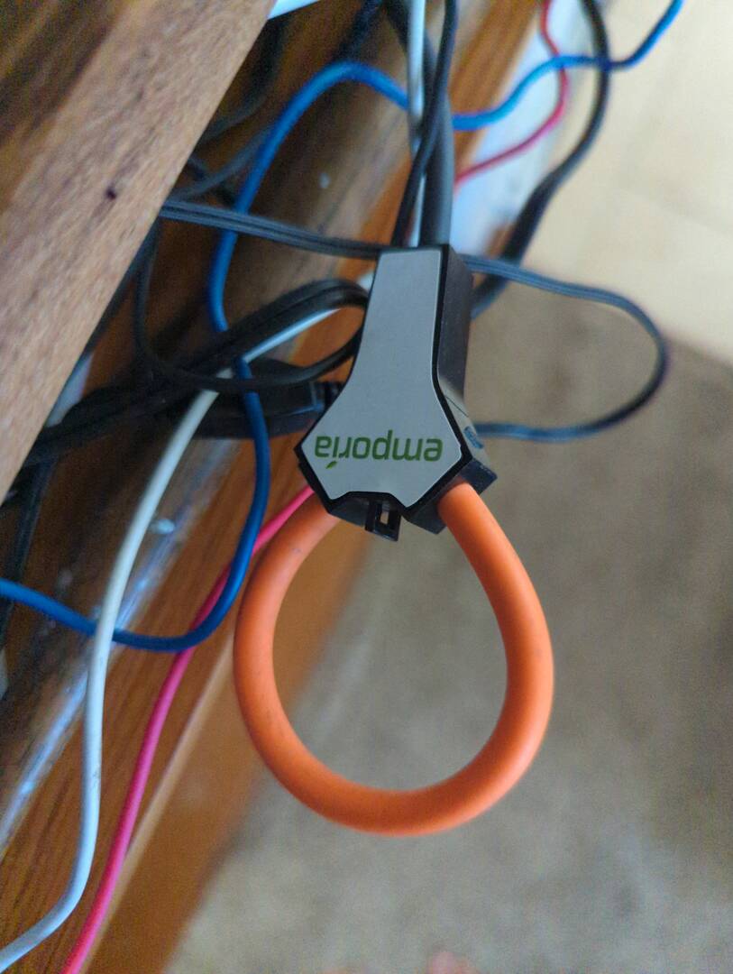

@powerup I currently have a grid tie inverter, so yes I can sell power back.  I have used emporias ct's in the past on the busbar connection
17585676596358953108286240155182
They are a bit tricky to install but they work, and
they require external power.  They may also work in the case, but they do not have a rj45 connection and I don't have the specs

@swiftsail Thank you, can you describe the integration?
Did you make your own RJ45 connection? Did you need to adjust Inverter settings for this to function?
