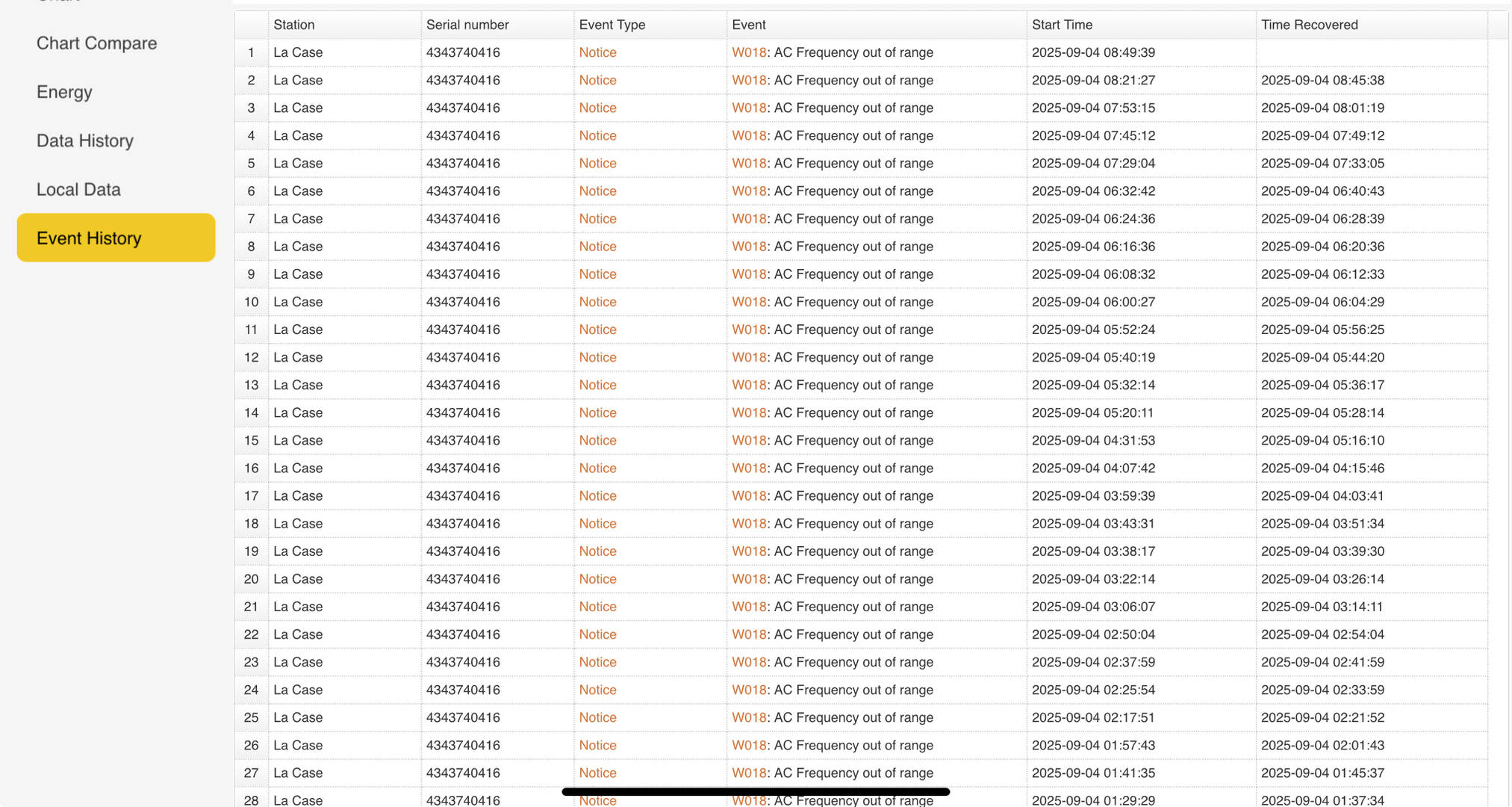

hello, on the monitor app, in the data, event history, i just noticed that the XP6000 was repeatedly telling that the AC Frequency was out of range. It usually clears up after a few minutes and the inverter never stops working. I have the frequency on the default 60 Hz. What is the issue?

Either the Grid or the Generator is fluctuating significantly in frequency, and it is outside the normal range.

I have no generator and i am not on the grid…. Only solar panels in two strings of 8 Blue Sun 460 W. I would imagine that the 6000XP would regulate the frequency?
When i look at the data recorded, it shows going in and out of the warning 18.

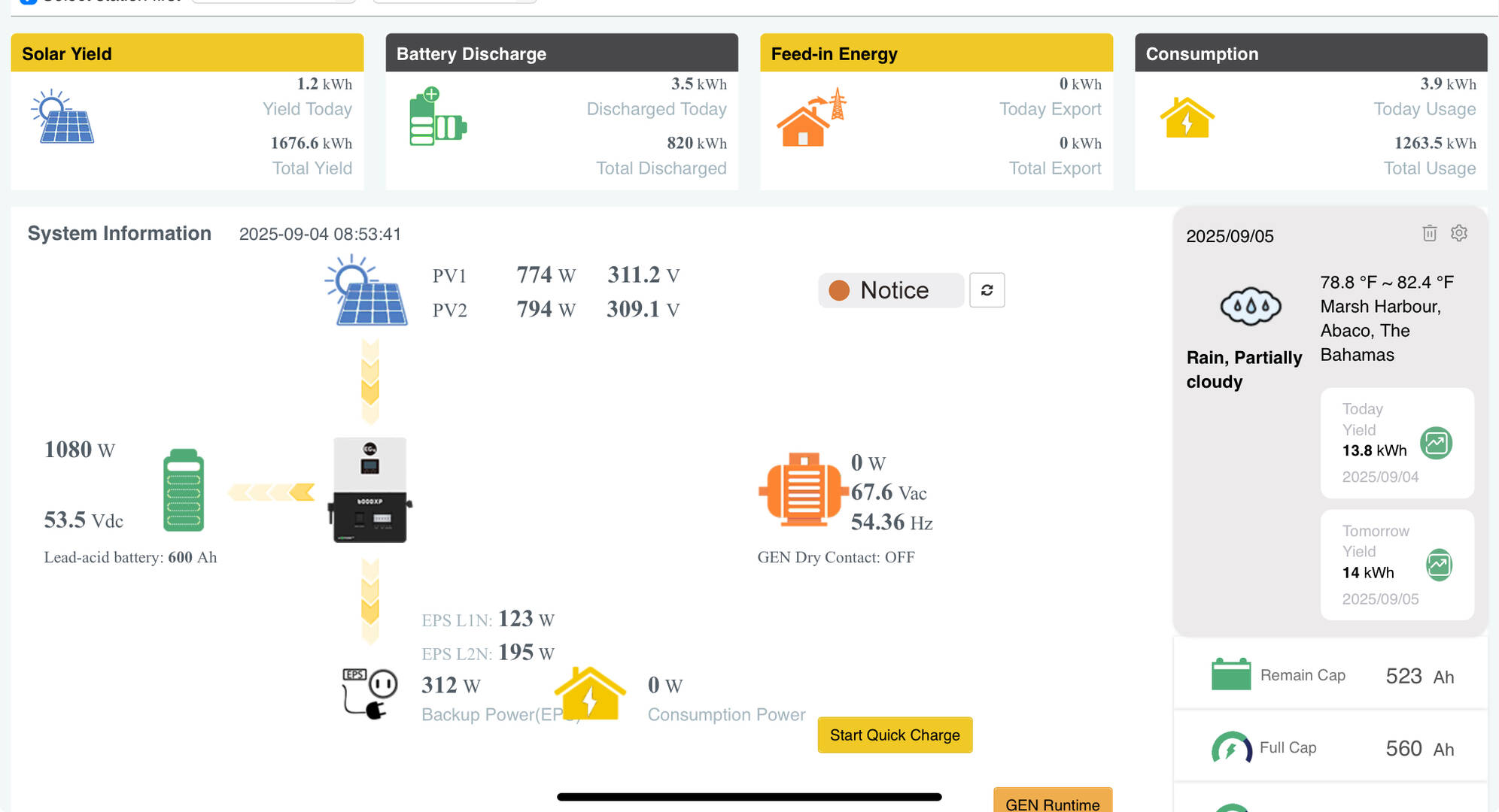

It shows a generator logo but i have none…this is my second inverter in and my system is not even one year old.

Posts: 1294
@ravasunpower
Make sure you have Generator Boost Disabled.

@eg4eric  thanks, i checked and the generator boost has been disabled since the first setup.
