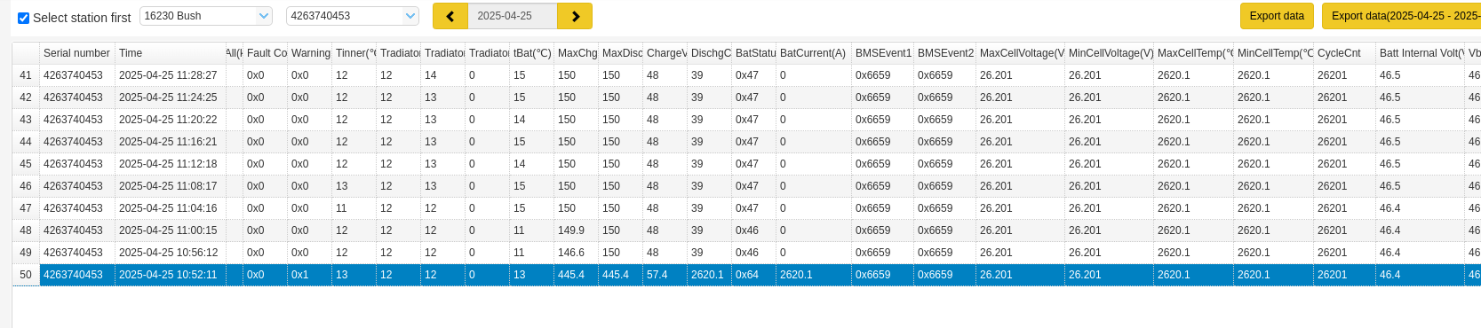

I'm seeing this again... notice that the max charge / discharge amps are always being sent as 90A. It appears like the inverter gets one bad packet (fails to validate checksum) and then the bad data sticks around in the cell volts / temps values. I've been under the impression that the 6000XP doesn't even use the cell volt measures from the RS485 pylon protocol. I'm sending them according to the spec, but it seems to ignore that part of the packet. If it's ignoring them, how did they get filled in?

Strangely enough, the "BMS Event" Column shows 0x6659 which is 26201 in decimal, the same as all those other corrupt fields.
I don't even know what "BMS Event" means, but it seems like some internal inverter state, not some field that's read from the protocol.

This continues to happen every so often.
It looks like occasionally the inverter is reading a RS485 packet full of `6659` repeating and doesn't validate the checksum, thus treating this corruption as truth and getting nonsense values.
The inverter (while this was happening) rapidly (every 10s) switched between off-grid mode and bypass mode. Not pictured here is the `vBat` which also was affected and was erroneously being read as the same `26.201v` value.
