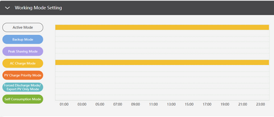

@eg4eric   just checking in..  i'm on fab-2727 now.
Posts: 1289
@captjwh
Apologies for the delay. It appears your system is set to AC Charge throughout the entire day. Was this setting applied before or after you started experiencing issues with the inverter exporting power to the grid before the batteries were fully charged?
