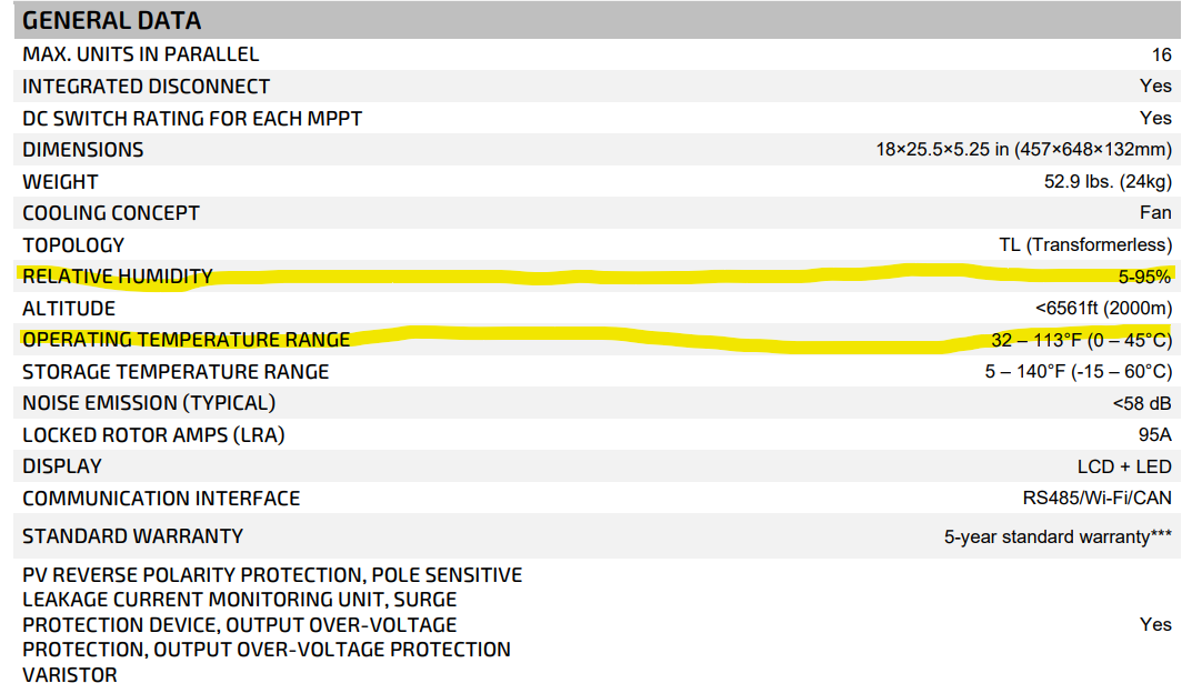

hello, What is the range of temperatures and humidity for inverters and battery room?

from the spec sheet:
EG4-6000XP-Inverter-Spec-Sheet.pdf
