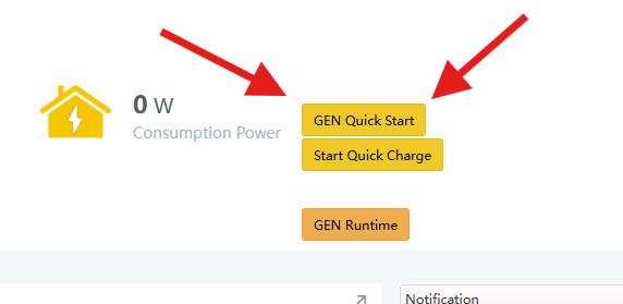

The GEN Quick Start on the EG4 monitor website is the same as the GEN Exercise.

Ok, but it isn't clear that that doesn't connect it. Gen Exercise should be starts the generator, runs it, confirms power to the terminals but doesn't link it in and continues normally.
So the terminology doesn't make sense (and it should be absolutely clear what it's doing)
And you should be able to schedule it.
