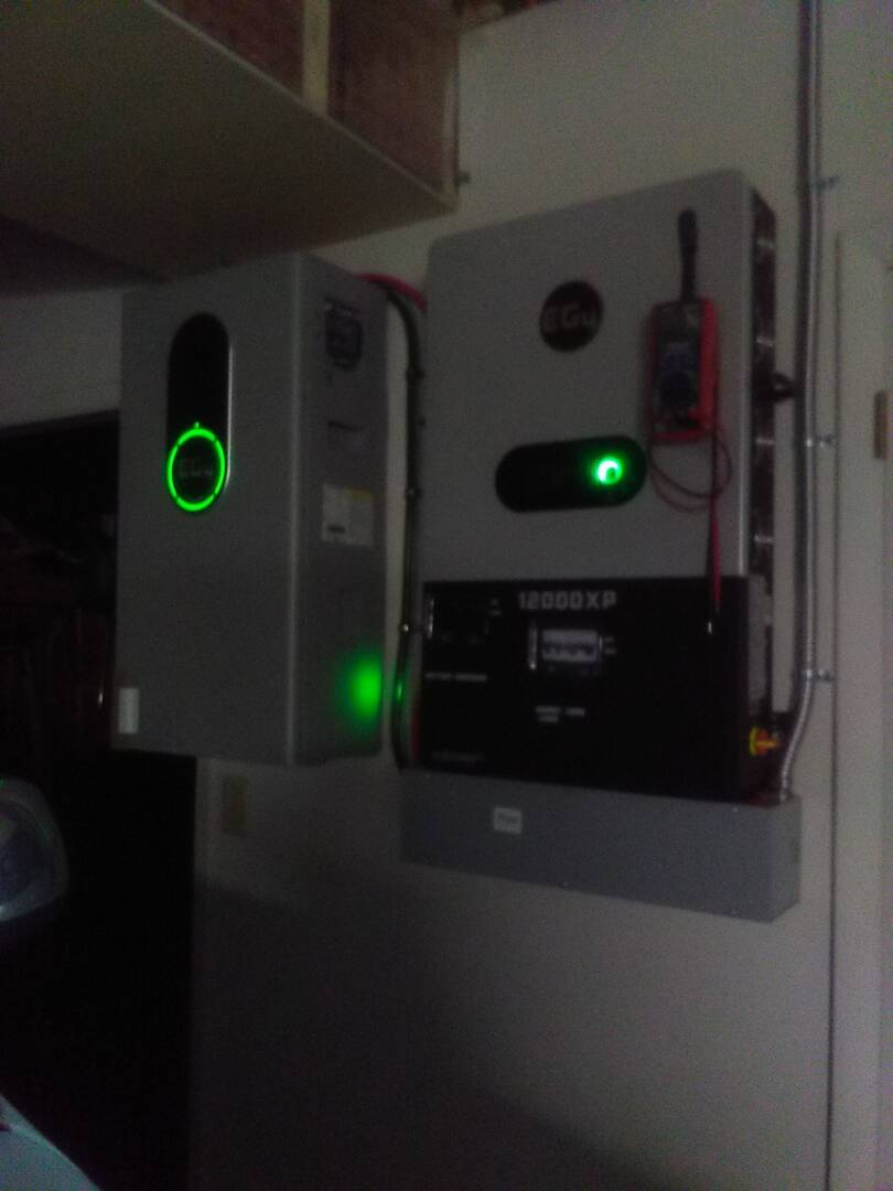

12000 XP with real wall mounted batteries (the second is on the other side of the wall).

System in construction or operation for a year with no big issues.  4500 watts of east facing solar (MPPT1) to get things going in the morning and ability to switch 6000 watts from west facing older grid tie system to MPPT2 when the grid goes south.
