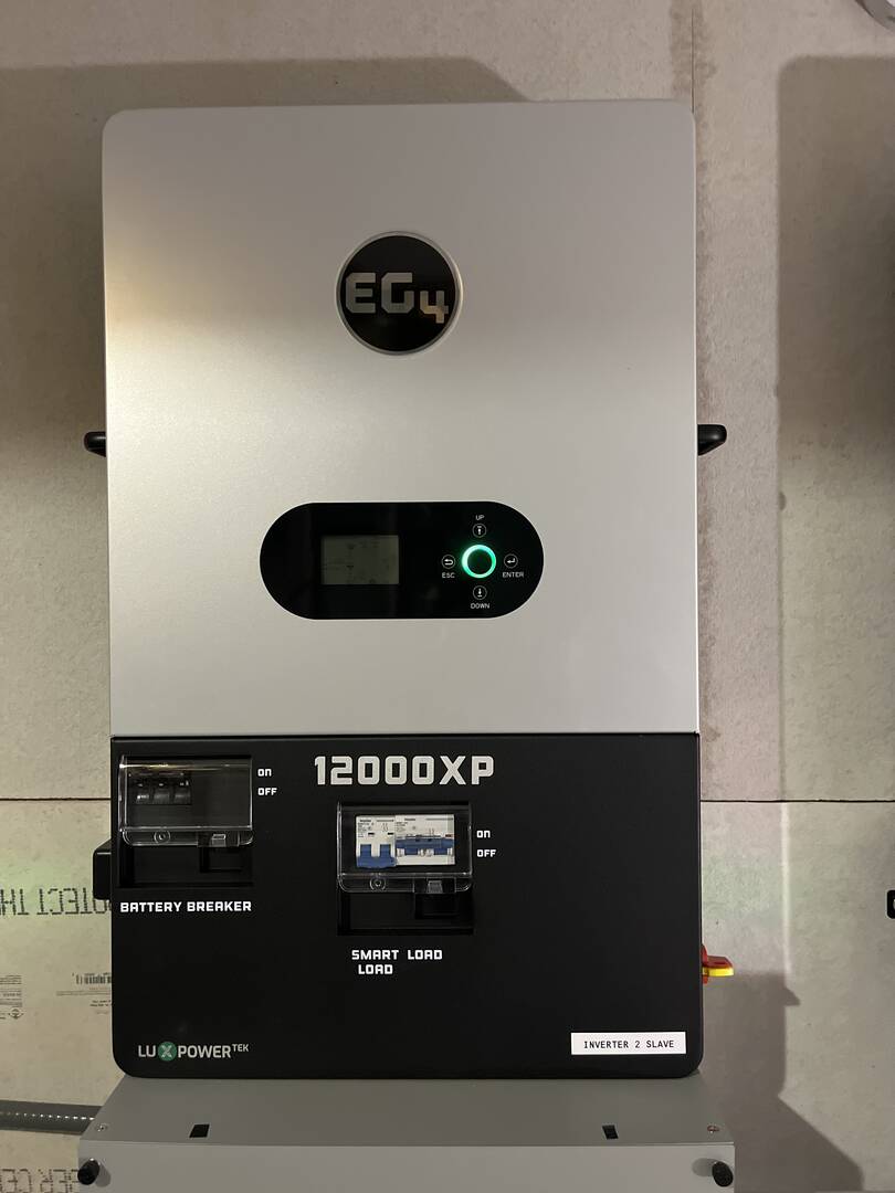

Pictures of inverter with high fan

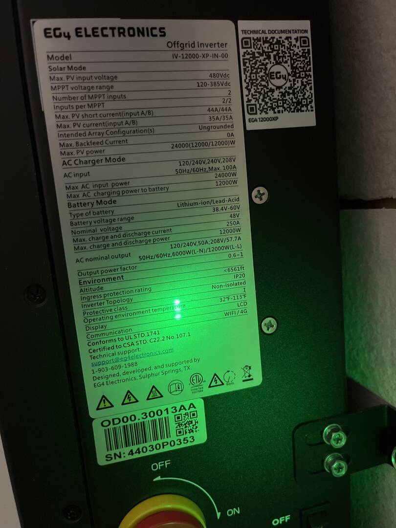

Inverter serial # is
44030P0353
