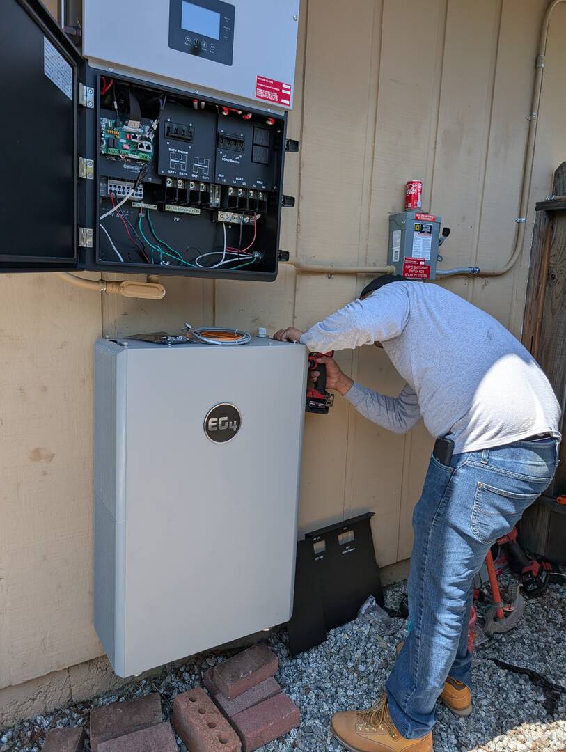

I have an eight 420W solar panel system with an EG4 18kPV hybrid inverter and the EG4 WallMount All Weather Lithium Battery. It was a pretty long journey from the initial stage of getting the panels installed with an inverter to where I am now, about 6 months. Issue was the initial inverter (Tesla) was not approved by PG&E for non-export mode (this is my second solar system). The solar company took a few months of back and forth to come up with a design that was approved. End result was I got a much better inverter (EG4 18kPV) and optimizers added to my panels. Once they came out to swap the inverter I learned about EG4 and that there was a battery available. I ordered one from Signaturesolar and had it installed last week.
I am now trying to figure out how to program things to charge the battery during the day when I have sunlight and then use it in the evening/night when I would be using PG&E power. If anyone knows of a guide I would appreciate pointers. The app and website have lots of data/features but is a little confusing to me. 🙂
PXL 20250526 215628557
Here is a picture of my inverter and battery during the installation of the battery.
