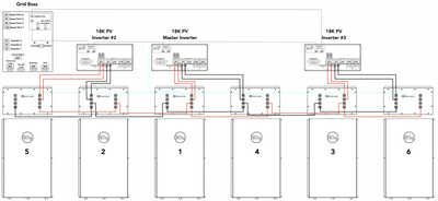

After reading through the question referenced below, I thought maybe my system could be wired in a similar fashion.
Could Dual Wallmount Batteries be Wired More Effectively?
https://forum.eg4electronics.com/community/support-batteries/could-dual-wallmount-batteries-be-wired-more-effectively/#post-16592
Any reason this could not be done?
Untitled 13
Posts: 1281

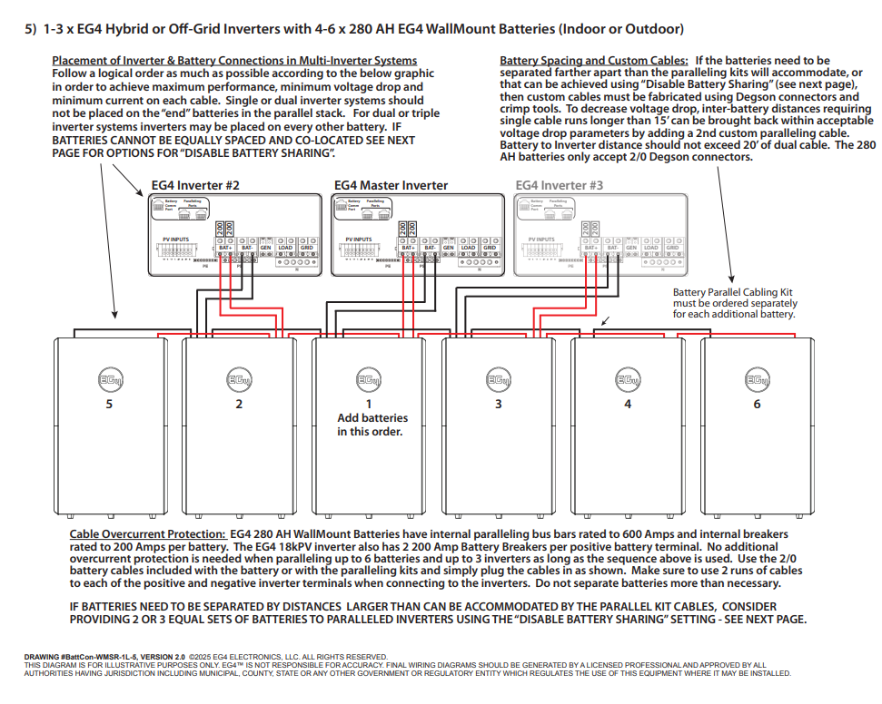

We recommend wiring them as shown in the image below. While there may be other ways to connect them, this method ensures proper charging and discharging performance.
