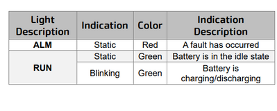

Is the simultaneous flashing of the "run" lites a true indication that the sync operation is complete?  Just trying to double check some BS on another site.  I suggested the user come here to discuss issues with his EG4 product.
If the Run light is blinking, that would mean that the battery is charging or discharging.
dfwtinker
(@dfwtinker)
Posts: 126
@eric
Ha!  I thought so!  Smile Thank you for clearing that up.
Another case of RTFM...  I include myself as well.
     and you can bet i will post that manual photo you included.
