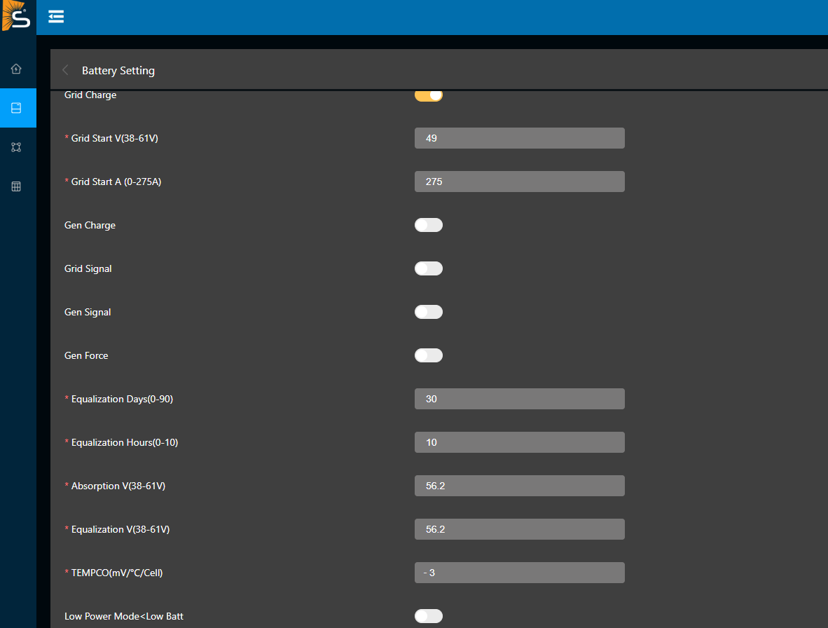

My system has been running since Oct 2024 and had several ARC faults I think that came from stranded wire termination and that was fixed. I wanted to reconfirm I have optimal settings (open loop communication):

How many WallMount batteries do you have?

Looks like your setting are correct for 3 EG4 Power Pro All Weather Wall batteries.   Only question is why do you have the Max A Charge and Discharge set to 260A and not 275A?   That's the only thing I would look at changing... I would want my batteries to charge as fast as possible.
