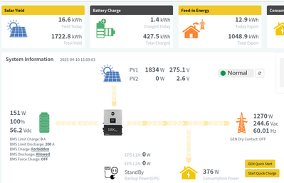

My EG4 system, which is made up of the EG4 12kPV Hybrid Inverter and EG4-WallMount Indoor Battery, is in backup mode.  It was installed in September of 2024. The average energy usage daily for ?? charging ?? is 1.4kWh. That is about 511kWh per year. Almost as much as my fridge.  I watch the dash putting energy into the battery every day. Like this:
Not sure it relates but I do have one cell of the battery lower then the others. Cell 12 is 3.477, all others are between 3.514 and 3.516.
In backup mode wouldn't it charge to 100% and just stay there? Any ideas if something is perhaps wrong?  A setting I can change to fix this?
