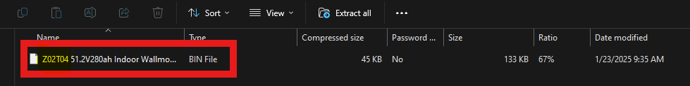

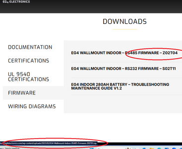

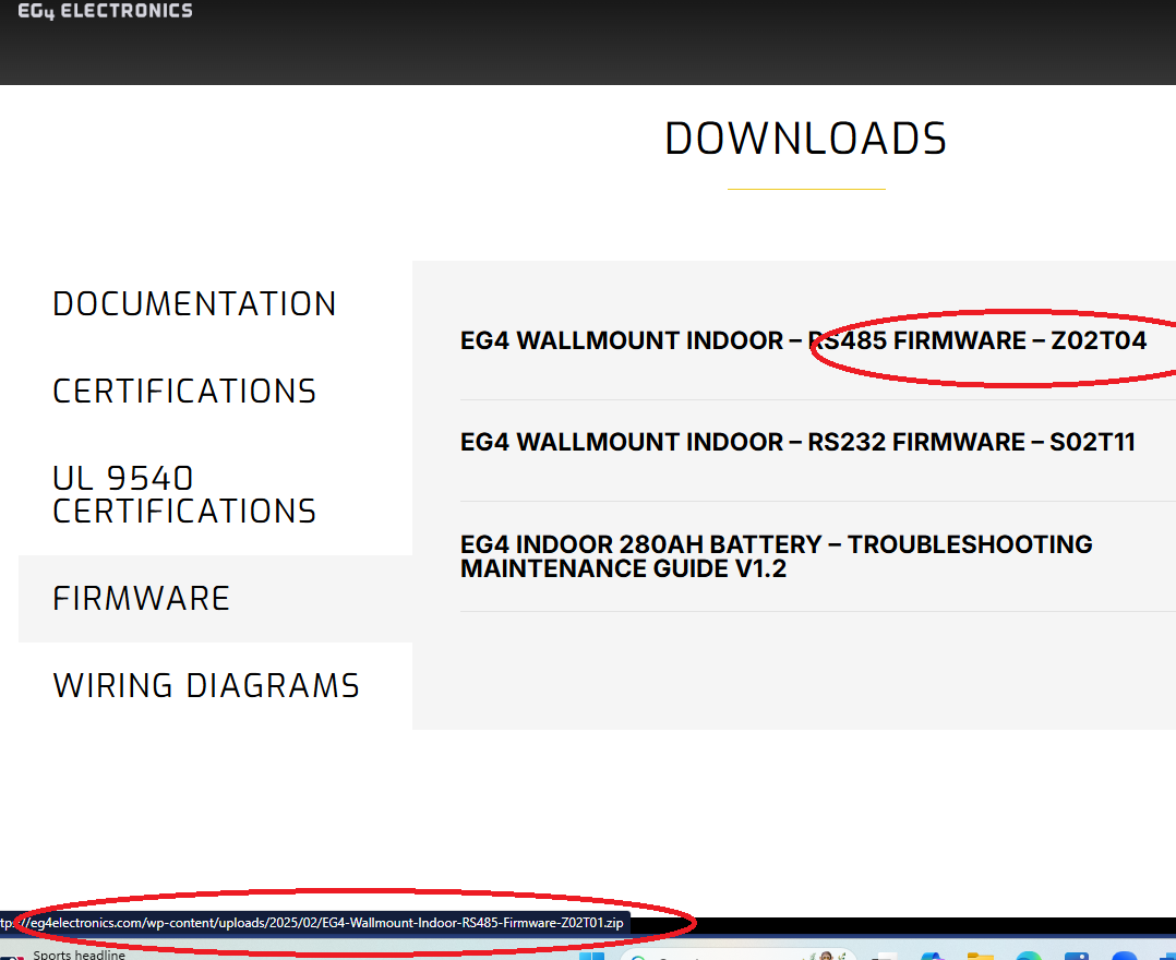

@eg4eric I went to download the latest Z02T04 today and although the Web page states that's the new 04 version, what downloads is the Z02T01 zip file !?? I think someone needs to review the actual files on your site. When you mouse over the download link you can see at the bottom of the attached screenshot the file its pointing to.
Posts: 1285
@swigley
Thank you for bringing this to our attention. It looks like it was just a typo in the file name, but I’ll report it so it can be corrected. If you open the file and click on the firmware folder, you’ll see that it contains the most recent firmware Z02T04.
