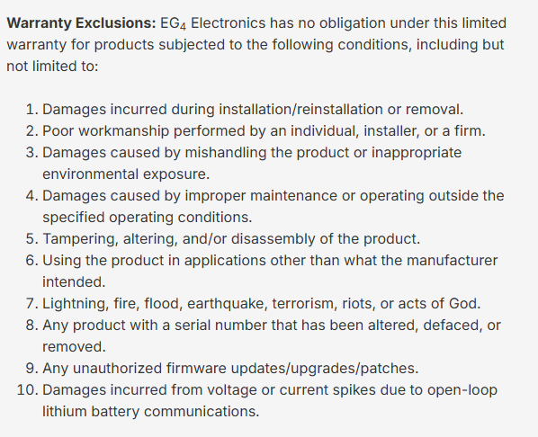

Q: if the BMS failed, is it covered by warranty? and how would I initiate a return/repair, or is there something I can check myself?
It depends on the specific issue. However, the best first step is to troubleshoot the problem before considering a replacement. It might be something minor, such as unbalanced battery cells. If the problem is with the battery itself and not caused by user error, it is typically covered under warranty unless the issue falls within the Warranty Exclusions as shown in the image below.
