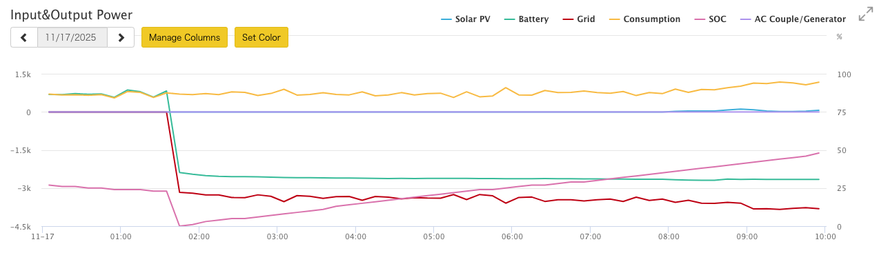

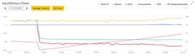

I've had a couple days now where my EG4 Wallmount Indoor 280Ah battery goes from 23 to 0% and kicks in AC charging. I've plugged in the BMS Tools via the RS485 cable, and there are no alarms before this happens. The app crashes after a bit so I can't let it run overnight to see more detail.
Any idea what would cause this? I have charged to 100% in the last 4-5 days, so the BMS should be calibrated right?

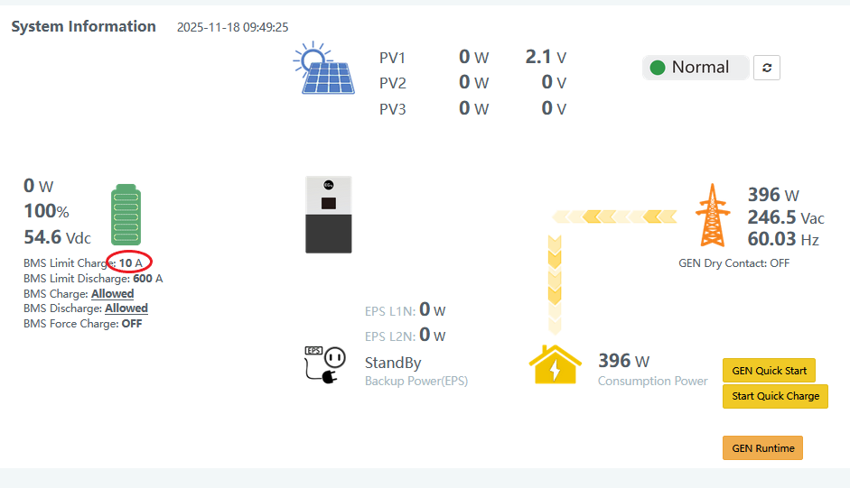

You may have reached a 100% charge but did you reach a full charge? One easy way to know if you actually fully charged your battery (and thus reset the BMS SOC reference point) is to look at whether or not the master battery signaled that the battery bank is full, by lowering the BMS Limit Charge parameter. You can look at your data history for the parameter named "MaxChgCurr(A)" at the time you think you achieved a 100% charge to see if this happened.
You can use open loop (lead acid) control to get to a full charge, but you can also do it using closed loop comm if you get your settings right, and you can use this BMS Limit Charge parameter to know if you're getting there.

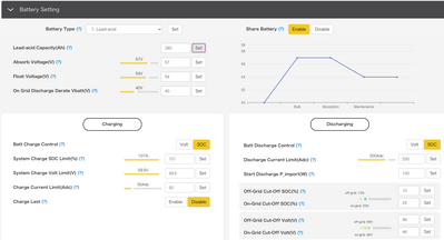

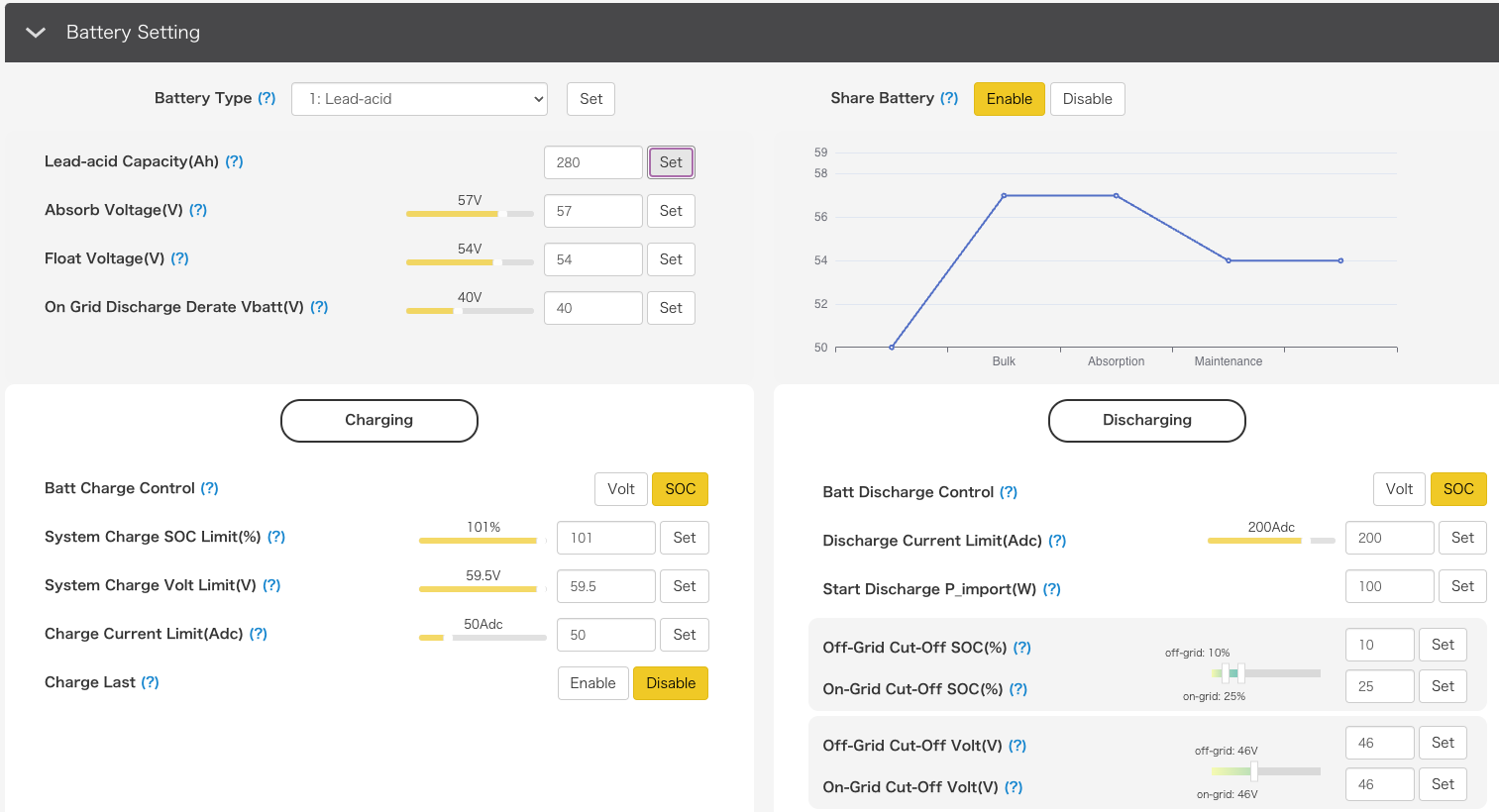

Do I keep the SOC settings for charging and discharging, just up the absorb to 57?
Posts: 1078
@michaelahess
Once you change the inverter to Lead acid, the SOC parameters will not matter since it's going based off of voltage. So, you will need to set the absorb voltage to 57V. The SOC can stay the same.
