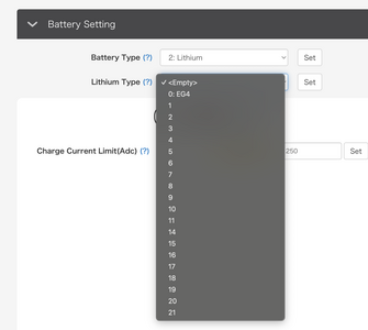

@eg4eric I am using Ruixu server rack batteries (RX-LFP48100) and like @chase, I haven't been able to get type 6 to work. I also did originally have success with type 12 - BYD, but the most recent firmware upgrade (ceaa-000507) doesn't let me choose type 12 as an option from the dropdown list (see attached screenshot). I was able to re-add 12 to the dropdown with the Chrome Inspector and push it to the inverters, and that seems to be working, but I'd like to know what the actual supported settings are for using a string of RX-LFP48100 batteries in closed loop communication.
Posts: 1073
@billmag
Thank you for bringing this to our attention, and I apologize for the inconvenience.
I checked several inverters with previous firmware versions, and they also do not have 12 as an option. I'm not sure what caused that, but I’ll bring it to our team’s attention.

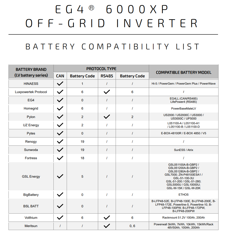

Because Ruixu batteries aren’t on the compatibility list for the 6000XP which is the same for the 12000XP, it can be a bit difficult to provide full support. The inverter will still function with this battery, but it wasn’t specifically designed to work directly with it.
Posts: 4
(@billmag)
Joined: 6 months ago
Is there any timeline to provide support? I noticed that the configuration which works (BYD #12) isn't on the screenshot you just shared either.
Posts: 1073
I don't have an answer as of now, but I will mention this request to our team.
