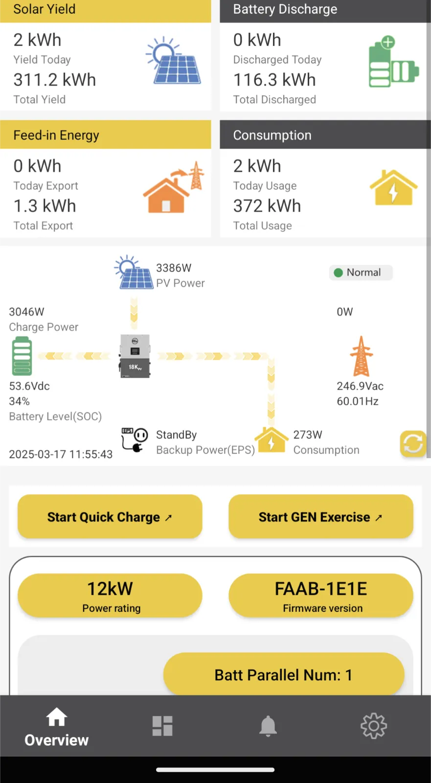

Have an 18KPV with solar, grid, and battery.

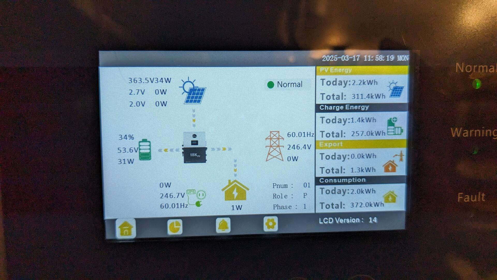

The app on my phone seems to display wattages accurately however the front-panel LCD on the 18KPV shows very low/incorrect wattage numbers.
Do I have a setting wrong?

Looks like I just needed to update the LCD firmware to the latest version (using a USB thumb-drive with the correct files).
Now displaying correctly.
